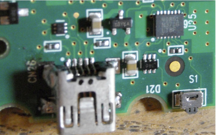

Does anyone know what the far left prong of the 5 prongs that slot into the USB connector does?
When my USB connector broke, it seems to have snapped off this far left prong. I only have 4 remaining.

omro,
If the socket itself is broken, it will need to be replaced. If the circuit trace on the board is damaged, the pin on the socket could be wired to the appropriate small hole behind the socket with a jumper wire (be careful). See the attached illustration; for reference, S1 (switch 1, on the lower right) is the DR’s Reset button.
A surface mount USB Minni B socket can be found at Digi-Key, on page # 66 (Molex USB Connectors, Figure 14) of their current catalog.
Type “Mini-B” USB, SMD, Bottom Mount
Digi-Key part # WM17141CT-ND
Single part price US $1.14, plus shipping
If ordering elsewhere, it is Molex part # 48242-0001
Digi-Key ships fast, and has no minimum order requirements.
On the DR1000, as seen from above (with the connector visible on the circuit board), the USB connector pin 1 is far left (marked on the board with a white dot). I’m not sure of your reference to ‘far left,’ but pins 1 and 5 are necessary for charging.
This is the Mini USB pinout:
Pin*********Signal*******************Color (for cable wires)
1*******VBUS (power +)*****Red
2*******Data -*******************White
3*******Data +******************Green
4*******ID************************<Ra_PLUG_ID (for a Mini AB socketed OTG device)
5*******GND (power -)*******Black
Shell**Shield*******************Drain Wire
I hope this helps.

It's the little prongs that fit into the USB connector. They are on the motherboard, the USB connector can be slotted over the top and then resoldered. However, if the far left one is a power prong, it's a bit pointless.

It's Okay, you're good! Your USB port has come apart, rather than come entirely off; it can be replaced. Those 'little prongs' are the socket's leads--they are soldered to pads on the board, and need to be removed to install the new socket.
Keep in touch,
Kent Walters
