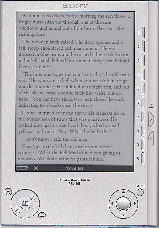

Well, I decided to upload a pic of Berling Antiqua. I don't know how you guys are getting such crisp images with a scanner. The screen is a bit out of focus on mine as it is further away from the plate.

I get the same fuzzy screen scan on my home scanner. I use the big photocopier (can do A3 paper) at work to scan; it must have better optics.

Ah, thats good to know. I'll give it a shot at work then.
