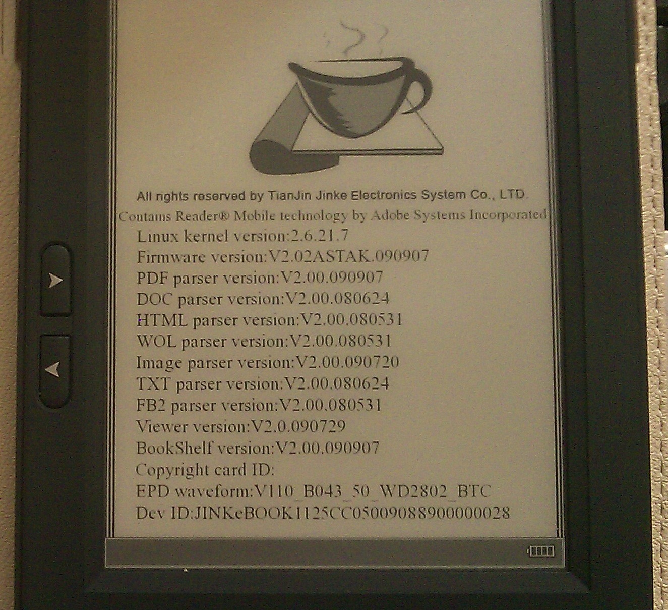

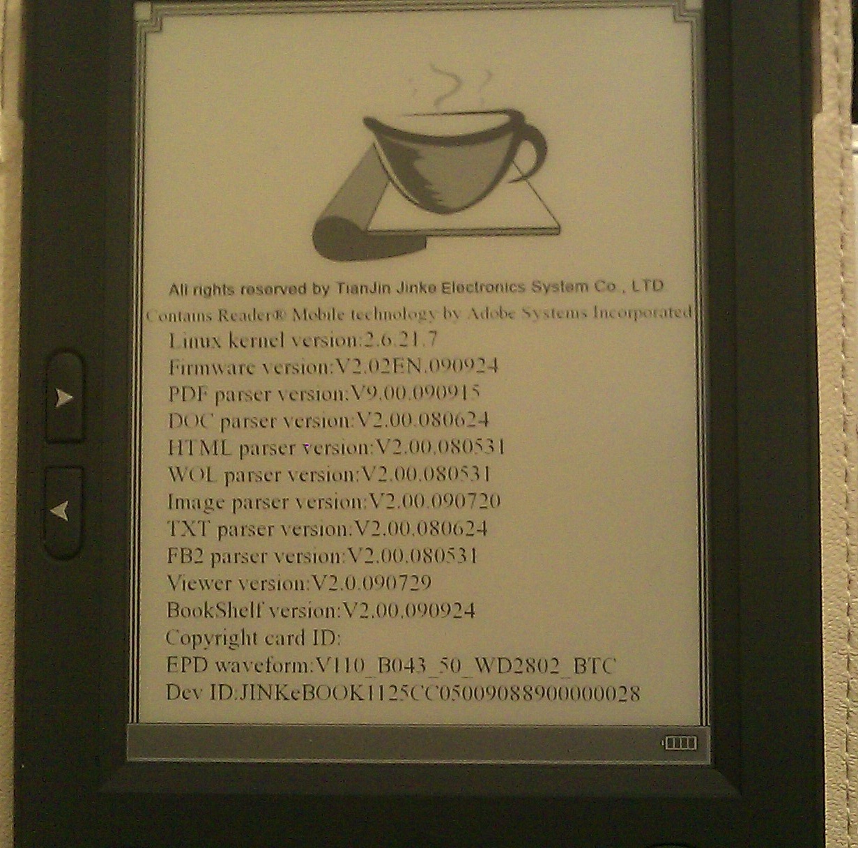

I have received the device today in Turkey and still reviewing it; so far not bad.
Edit: My device is 5-Inch Pocket PRO ebook reader.
Hovewever I have a small problem about the firmware update.
I have downloaded the latest firmware from http://www.theezreader.com/html/support_firmware.html page and installed on the device as requested. But there seems to be a confusion; when I select Menu - Settings - About, after the update, the firmware version is shown as V2.02.ASTAK.090907 however, it should be something like 09102009 as far as I can understand from the file name which is http://www.theezreader.com/firmware_...k.09102009.rar
I am attaching two images, one just before the update; second after the update.
Can someone please tell me if I am using the latest update?
I also protest Astak for not putting an update history or a release log on their site. There's no way of knowing if I have the latest firmware on my device.
I would be happy if you could help.
Regards,

if that is the ezreader pro then that is the latest firmware for it is for 9/10/09
Chuck

I am not sure what it should show, but the firmware date doesn't have to be the same as the file date. It's possible they tested it for 3 days before posting it online.

As of Version: (1) shipped, (2) 20090910,
"All rights reserved by TianJin Jinke Electronics System Co. LTD.
Contains Reader® Mobile technology by Adobe Systems Incorporated.
Linux kernel version: 2.6.21.7::2.6.21.7
Firmware version: V2.01ASTAK.090825::V2.02ASTAK.090907
PDF parser version V2.00.090730::V2.00.090907
DOC parser version: V2.00.080624::V2.00.080624
HTML parser version: V2.00.080531::V2.00.080531
WOL parser version: V2.00.080531::V2.00.080531
Image parser version: V2.00.090720::V2.00.090720
TXT parser version: V2.00.080624::V2.00.080624
FB2 parser version: V2.00.080531::V2.00.080531
Viewer version: V2.0.090729::V2.0.090729
BookShelf version: V2.00.090825::V2.00.090907
Copyright card ID
EPD waveform V110_B043_50_WD2802_BTC
Dev ID: JINKeBOOK1125CC05009089200000154
These are the updates on the Astak Pocket Pro, i.e., Hanlin v5. however, your first picture, with the Hanlin update, I never saw on my system. Maybe because I had it off when I started the download???

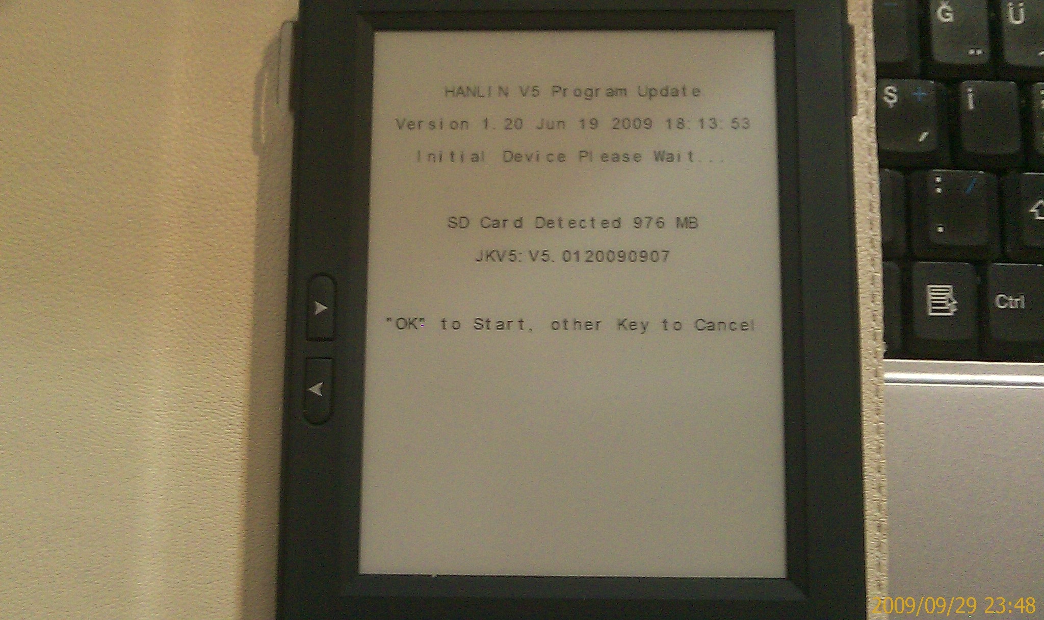

After all unsuccessful firmware update attempts with the original update file I gave up and downloaded Hanlin V5 update from here: http://www.jinke.com.cn/Compagesql/E.../update_v5.asp
I have read somewhere in the forums that these devices are same; so I setup this update without a problem. Now the info screen of the device shows the attached image.
The device has been updated and works better; EDIT: .txt and .doc files have still three display level; 1. the original, 2. zoom mode 3. landscape mode.
Meanwhile please note that there seems to be two differences between the updates: The Astak PDF parser and Bookshelf version is 090907, the Hanlin for both versions 090924. I don't know though if the bigger number means more developments or does it just differ because of different company names?
After the update only my welcome and shut down page has changed; other than that it's the same.
I recommend the other users, without taking any responsibility, to give it a try.
Regards,
