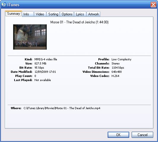

Here's what iTunes has to say about a file that doesn't play on the 3G Touch, and one that does. Both files play perfectly in iTunes, and the one that doesn't work on the new Touch works perfectly well on the old one, and on the iPod Classic.
Does this throw any light on the matter?
Name:	Info1 - Doesn't work.jpg
ID:	36006   Click image for larger version
Name:	Info2 - Does Work.jpg
