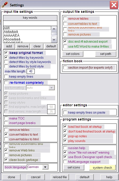

I copy the files to the "Program Files > Book Designer > BookCleaner" folder (1.bcf, 2.bcf). Note that there are also 3 other files already there (MiddleDashes_after.bcf, MiddleDashes_before.bcf, RemoveRepeatedEmptyLines.bcf).
Then in Book Designer I go to "Tools > Book Cleaner" and then select 1.bcf in the "input file: before formatting" drop-down box, and 2.bcf in the "input file: after formatting" drop-down box. Then close the window.
I have checked regularly that the 1.bcf and 2.bcf files are still loaded as described above, and they always are. Should the "loaded book" section be marked as whole? I assume that is only if you want to manually trigger the clean-up again, and when the book is first loaded the cleaner files run?
Am I missing anything else? My language is selected as German, and I think I have fairly basic settings selected for the program overall - see the attached pics for screencaps of my settings and the Book Cleaner window.
I have noted in other posts that MS Office seems to have some effect omn Book Designer functions - is this also the case for Cleaner?
Thanks for any help.

That all sounds perfectly correct, Orwell.
So, the next thing to ask is how you load your texts into Book Designer.
Book cleaner won't work if you are cutting and pasting.
I open BD then drag and drop the source text into the BD window. At the bottom of the window, there's a little commentary, where it tells you that it's finding paragrah ends, running book cleaner etc.

I am almost always opening an HTML document in Book Designer (File > Open), sometimes a LIT, DOC/RTF or TXT file. But always via Open File not cut and paste. I also see the little "status" message saying "finding paragraphs ends" and so on.
Having wasted your time, I have now just run some further tests, and it seems I am getting em-dashes preserved in most documents I try. I don't know what happened, but I can only guess that I had one strangely formatted source document that meant I lost the em-dahses. I will keep an eye on how it performs with further documents. My apologies.
Of course, I still have the problem of losing images when the Book Cleaner files run on opening a new source file. This is quite troublesome, and I guess we are unlikely to get that issue fixed?
Thanks again for your help, and apologies for the false alarm.

I make sure that I have checked the "save pictures" options in Configuration/settings. Even so, I frequently have to add the pictures by hand later.
