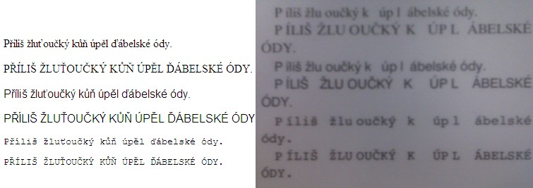

Here are my results; left as it is displayed in Firefox, right as displayed on my reader. I only have my crappy Blackberry camera on me, so I had to put the reader into landscape mode to even make a half-decent pic.
I have the default fonts on my reader (never bothered to tweak), it appears I am missing some letters, but it displays sans just fine. I have the latest firmware for the 505 loaded.

Thanks for trying it out. Your images look like they should. It must be a font issue then, but what? It can't be just custom fonts, because I had had to use custom fonts to get correct letters, but for some reason with my current fonts the reader will only display serif inside books :-(
