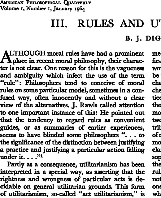

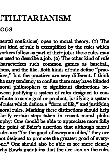

Hi, I'm having problems getting PDFread to split the columns evenly when using the 'portrait-2col' layout.
Here's my command line:
python pdfread.py -p prc-mobi-p -m portrait-2col -d tmp --mono --no-toc diggs.pdf
I've attached the source pdf and two mismatched output pngs so you can see the problem.
ID:	35161   Click image for larger version
pixnaps is offline   Reply With Quote
Sorry, that's a known shortcoming with PDFRead; try PaperCrop instead, as per this post.
PDFRead just blindly picks the middle of the page, not the blank space between the columns.

Thanks, yeah I used PaperCrop in the end. I was just puzzled because in this case the blank space IS in the middle of the page. If you look at the output PNGs, the left one is wider than the right. So PDFread isn't splitting the page evenly in this case.
