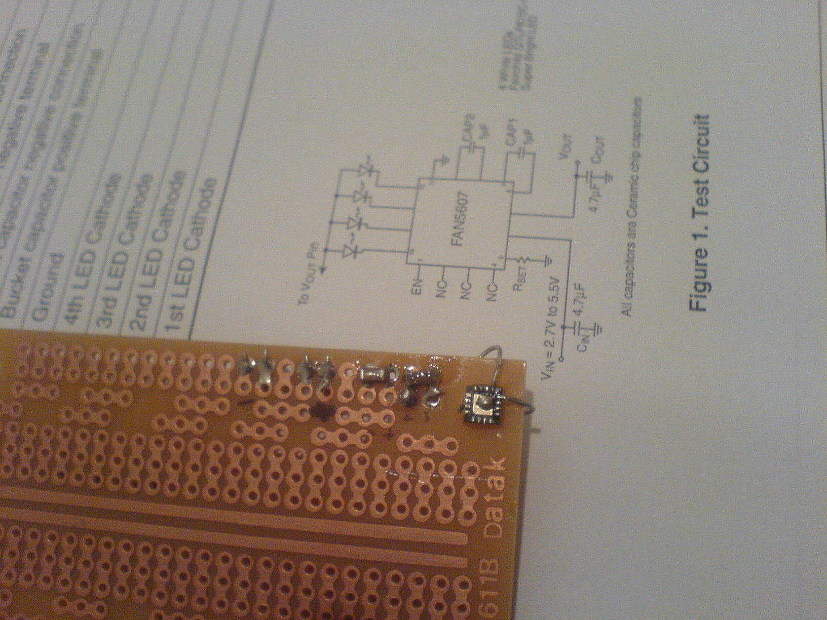

Ok guys I've started soldering this thing up. Holy moly those solder pads are incredibly hard to solder. I need to know how to wire it up. I'm connecting V+ to the Vin pin with a 4.7 uF cap going from + to grd. V- connects to Vout with a 4.7 uF cap from - to grd.
uh, what is ground in this circuit? do I just solder the GRD pin and the caps negative leg to together to get ground?

Old 01-31-2007, 10:25 PM   #40
NatCh
Gizmologist
NatCh's Avatar
Posts: 11,615
Karma: 929550
Join Date: Jan 2006
Device: Pocketbook Touch HD3
Ground is gonna effectively be the negative terminal of your power supply....

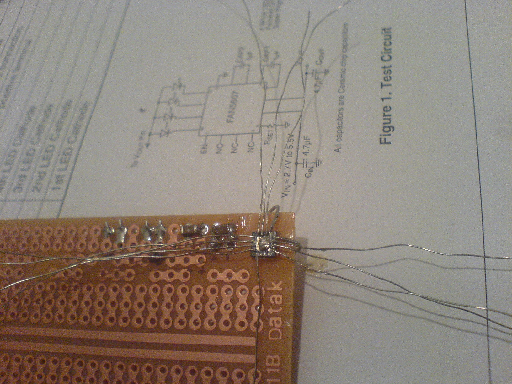

So I would solder both leads of the negative filter cap to the same terminal ? this is so confusing. You can see it on the Vout terminal in the picture.
By the way, Obelix, your method of breaking up stranded wire was brilliant, and it allowed me to finish soldering to the rest of the terminals. of course it took me all night, but I got it.

You're right, that doesn't sound right.

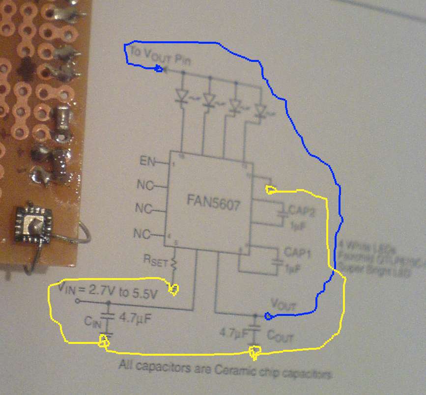

Ah, I think I see the problem, Vout isn't V-, it's the output power for the LEDs.
Here, I've marked up the schematic a bit, blue for Vout and yellow for ground/V- connections, hopefully that'll clarify it some.

Ohhhh Duh. Yeah. V- will be ground, not Vout. Oh well, that's what I get for trying to work at midnight.
