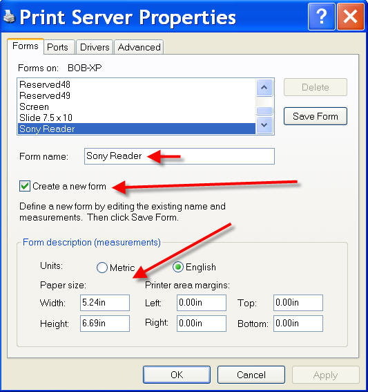

Can I ask how you predefine the PDF page size for your PDF printer? What PDF printer do you use?
Thanks
Create a new form in Print Server Properties. (To configure printer settings, click Printer and Faxes in Control Panel and select the printer) In Print Server Properties, on the "Forms" tab select " Create a new form" and define the page as 5.24 in Width and 6.69 in Height with 0 for all margins.
I use Adobe Acrobat 7.0
This seems to be my problem. I looked at home, and also on the PC at work (which has Adobe Acrobat and PDF printer), and I couldn't see a "Print Server Properties" or "Forms" on either of those. Is those only on particular installs of XP, or somewhere else to look?
Many thanks for your help!
Open "Printers and Faxes" from Control Panel
Pull down the "File" menu
"Server Properties" is one of the selections, click it
You get the form below and fill it out as indicated.
