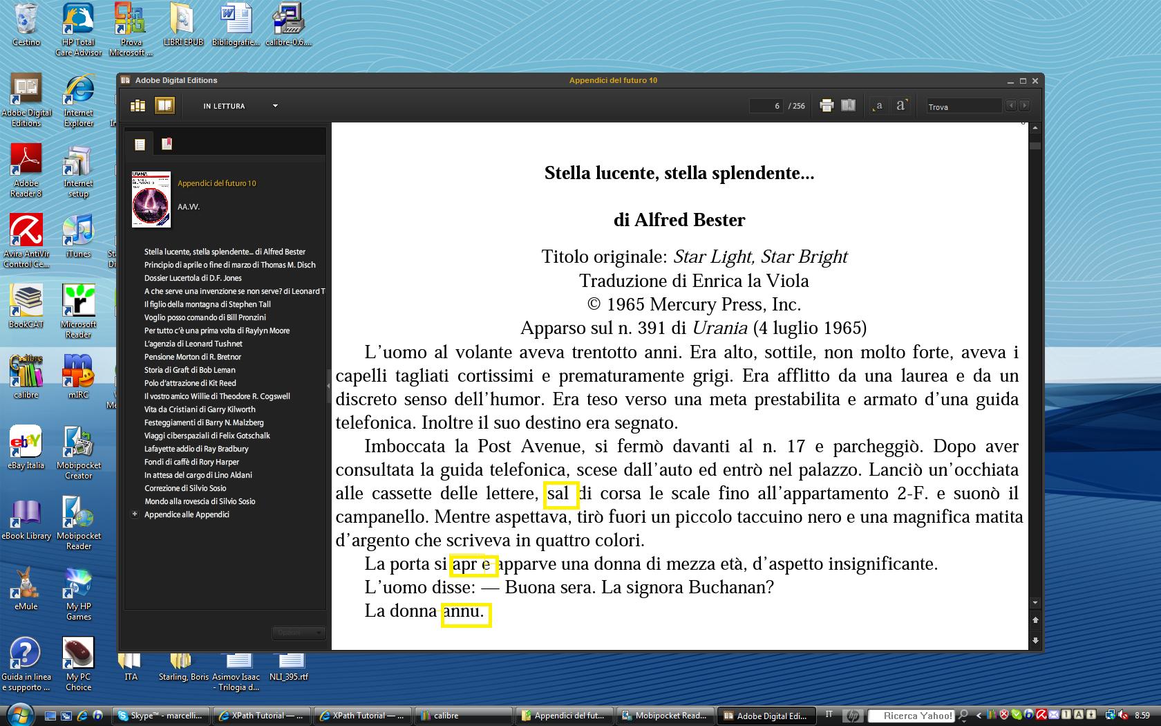

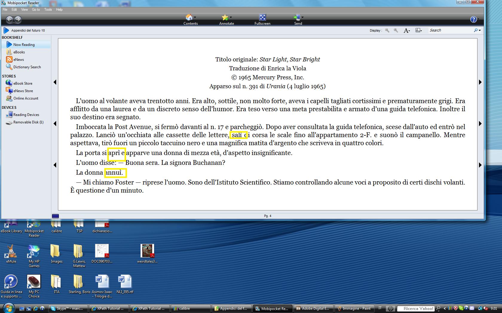

Missing letter ì
Hello,sorry for my english i am italian.A strange thing happens.I have all my book in mobipocket.I put it in calibre then i convert it into epub.I read it but the letter ì is missing.I attached image and see the yellow word.Thanks.
ID:	33011   Click image for larger version

@Angela: Opena ticket and attach the MOBI file showing this problem.

Thank you Kovid I open a ticket.This is the number Ticket #2953 (new defect)
