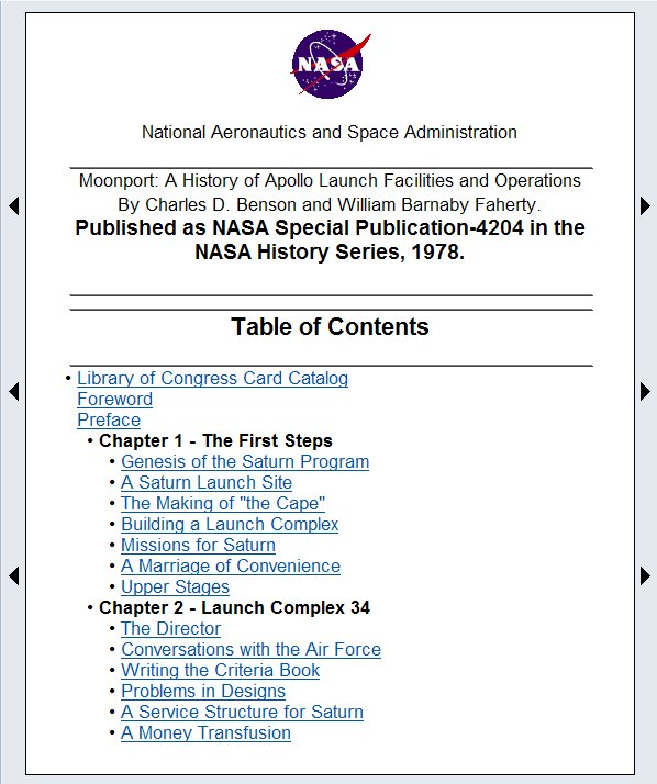

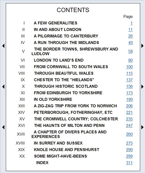

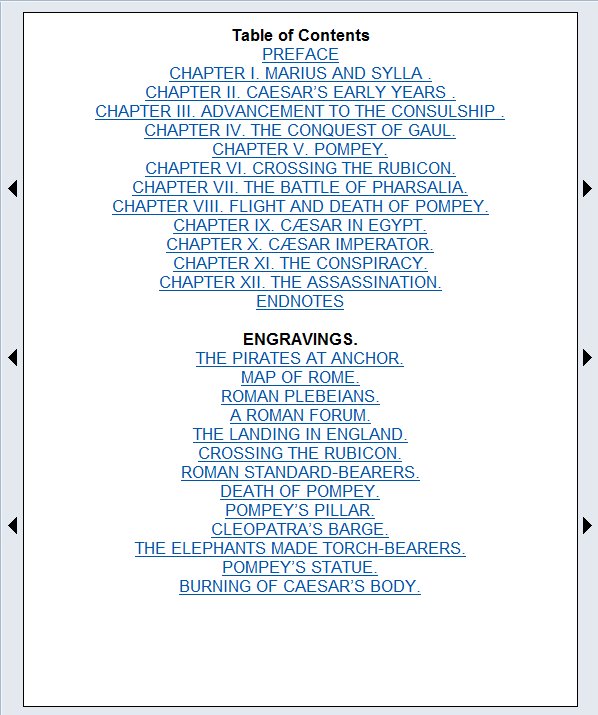

Originally Posted by crutledge View Post
My books have been critisized both for centering and left justifying the TOC. Which is considered best practice?
I prefer a left aligned (indented ala lists) TOC, but a well done tabular i.e. rectangular centered one is also appealing (symmetry-wise). The hourglass centered ones are cute, but not as "professional" looking, IMHO.
But, you can't please everyone, so just go with what appeals to your senses (as well as many of your downloaders... )
ID:	32524   Click image for larger version
ID:	32525   Click image for larger version
ID:	32526   Click image for larger version
Last edited by nrapallo; 07-18-2009 at 03:05 PM. Reason: added some screenshots...
