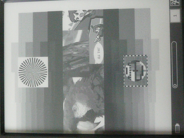

Originally Posted by mtravellerh View Post
Here comes your pic, Godzil
Attachment 32449
It seems like the picture looks pretty ok to me!
I'd not be able to say if it only had 4 grey scales!
Can you try to show a picture of how these photo's looks like on the cooler?:
http://realcolorwheel.com/tablet.htg...nwide72dpi.png
http://bluelobsterart.com/wordpress/...r-wheel-lg.jpg
I'm interested in how the color palette displays and how the color changes (light to darker) are being displayed.
Thank you!

Ho good pictures too
Thanks, I will test them on my own Cybook
Thank you!
