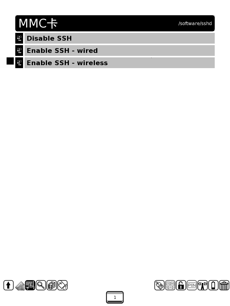

Hi all,
I just add a little function to hansel's new contentlister, I add three icon to the toolbar in the main windows at bottom of toolbar near left side three function search/sort/share, the three icon from left to right are implement with:
up one directory when browse in content lister
up to the root directory when browse content lister
shutdown iliad
I just compile it a few month ago, and it modified based on hansel first version contentlister, I don't know whether it will work or brick your iliad after hansel's 1.0.5 version, so install at your own risk.
how to install:
1.you need install hansel 1.0.4 version new contentlister first.
2.untar the package
3.copy all the icon inside the icon folder to /usr/share/pixmaps
4.copy liberipc.so.0.2.0 to /usr/lib/ and check the file permission with 755, important: you need confirm that after copy the old soft link liberipc.so.0 are link to my version of liberipc.so.0.2.0, it should be overwrite with mine, or the new contentlister won't take effect. I just find it still link to the old liberipc.so.0.2.0 after restart, so I decide overwrite the link liberipc.so.0 with the liberipc.so.0.2.0, actually iliad use liberipc.so.0 to work
5.copy newLister to /usr/lib/ overwrite the original one and check the file permission with 755.
6.copy toolbar.xml to /etc/registry/ overwrite the original one.
pls ensure you backup every file that will be overwrite.
My iliad is chinese version, I don't know whether it work or not with european version, but I think it should work, because it modified based on hansel 1.0.1 version.
The attach is screen shot and the file used and the source I modifed.
Try and report here if sucesss or not, then other people can known whether it's useful or not.

to ericshliao:
I have the same idear for implement icon to execute scripts, but I don't know how to do it. I think it's doable so I write down the code that been modified, it's relative easy, hope someone can get it and make a better contentlister.
1. in liberipc/src/eripctoolbar.c add the icon map in function iconMap_t g_icon_map_table[] like this:
{iconID_uplevel, "uplevel"},
{iconID_upmostlevel, "upmostlevel"},
{iconID_shutdown, "shutdown"}
2. in liberipc/include/eripctoolbar.h add the iconID to enum e_iconID_t like this:
iconID_uplevel,
iconID_upmostlevel ,
iconID_shutdown
3. in newLister/src/control.cpp add the action been triggered when click the icon like this:
case iconID_uplevel:
CL_LOGPRINTF("OVERVIEW_BUTTON");
pm_SendKey(GDK_F5);
break;
case iconID_upmostlevel:
CL_LOGPRINTF("OVERVIEW_BUTTON LONG");
pm_SendKey(GDK_Home);
break;
case iconID_shutdown:
ctrl_shutdown();
break;
the function or script been called should be handled here.
4. in newLister/src/toolbar.c add the toolbar icon like this:
tbAppendPlatformIcon( toolbarChannel, ER_CONTENT_LISTER_UA_ID, iconID_uplevel, ccClToolbarIcon);
tbSetStatePlatformIcon(toolbarChannel, ER_CONTENT_LISTER_UA_ID, iconID_uplevel, iconState_normal );
tbAppendPlatformIcon( toolbarChannel, ER_CONTENT_LISTER_UA_ID, iconID_upmostlevel, ccClToolbarIcon);
tbSetStatePlatformIcon(toolbarChannel, ER_CONTENT_LISTER_UA_ID, iconID_upmostlevel, iconState_normal );
tbAppendPlatformIcon( toolbarChannel, ER_CONTENT_LISTER_UA_ID, iconID_shutdown, ccClToolbarIcon);
tbSetStatePlatformIcon(toolbarChannel, ER_CONTENT_LISTER_UA_ID, iconID_shutdown, iconState_normal );
5. copy the icon picture to /usr/share/pixmaps/ folder, for my version, I copyed uplevel.png/upmostlevel.png/shutdown.png total 9 files to this folder (see from the tarball), maybe just this three does work.
6. add the name of icon to the toolsbar.xml like this:
<toolbarIcon name="uplevel">
<iconFileName id="1">uplevel.png</iconFileName>
<iconFileName id="2">uplevel_grey.png</iconFileName>
<iconFileName id="3">uplevel_selected.png</iconFileName>
</toolbarIcon>
add copy it to /etc/registry/ overwrite the original one.
Cause I compile it a few month ago, I just remember above step to change, so pls be carefully do it when you use it. I suggest you that when you want to use the new contentlister, pls add some code at /home/root/startup.sh to change back to use original contentLister every time you boot up and manully change it to the new one after you test in case this one have problem, when you confirm the new one have no problem, you can safely remove the code that switch to old original contentLister.
I switch for more than five times to get the new contentlister to function normally. For the liberipc.so.0.2, I think it's safe to overwrite because it just add the icon to toolbar, nothing else.
For the top-most black bar clickable problem, I don't know, maybe hansel can tell.
