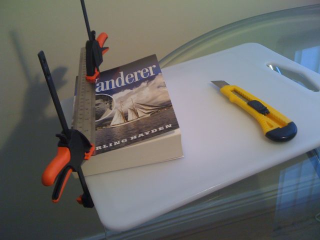

Old 12-18-2009, 11:45 AM   #25
seanmc8000
seanmc8000 began at the beginning.
Join Date: Oct 2007
Device: Sony PRS-505
Question Box Cutter & Stainless ruler
Just thought I'd throw up this photo before I destroy the book.
My plan is to clamp the steel ruler down hard, and use it as an edge for the stanley knife.
Will this work to remove the binding cleanly? I am using a Snapscan 1500M to scan the pages.
Thanks in advance. Sorry about reviving an old thread.
Name:	Binding Remover.jpg
seanmc8000 is offline   Reply With Quote
Old 12-18-2009, 12:16 PM   #26
Jack Tingle
Punctuation Fetishist
Jack Tingle ought to be getting tired of karma fortunes by now.Jack Tingle ought to be getting tired of karma fortunes by now.Jack Tingle ought to be getting tired of karma fortunes by now.Jack Tingle ought to be getting tired of karma fortunes by now.Jack Tingle ought to be getting tired of karma fortunes by now.Jack Tingle ought to be getting tired of karma fortunes by now.Jack Tingle ought to be getting tired of karma fortunes by now.Jack Tingle ought to be getting tired of karma fortunes by now.Jack Tingle ought to be getting tired of karma fortunes by now.Jack Tingle ought to be getting tired of karma fortunes by now.Jack Tingle ought to be getting tired of karma fortunes by now.
Jack Tingle's Avatar
Posts: 557
Karma: 1070000
Join Date: Nov 2008
Location: The Bluest Commonwealth In East America
Device: Kindle PW, Nexus 7 (2013), Galaxy S5 phone, Galaxy Tab 4 8.0
Personally, I'd pay a pro to do it for me. A buck isn't a lot for this kind of service.
If you do this a lot, find a nice woodworker with a bandsaw in her basement and make up some kind of clamp. The actual sawing should take about 2 seconds per book. If the bandsaw has a vacuum attachment, so much the better. The finer the blade, the better. Second choice would be a miter box or chop saw.
For safety reasons, I strongly recommend against using an unguarded razor knife. If you must do that, get a mail glove at a woodcarver's shop.

A book binder should have a professional guillotine to cut the edges straight. Just ask them to cut the fourth edge. I wouldn't be surprised if they did it for free, in less than 10 seconds.
Old 12-18-2009, 12:22 PM   #28
Silverexpress
Silverexpress began at the beginning.
Posts: 11
Karma: 12
Join Date: Apr 2009
Device: PRS700
I had a similar setup as you, but I used a dremel instead of a knife. Fast, effective, and messy. It left quite a bit of dust on everything, and this easily fouled the glass surfaces of my Fujitsu SnapScan. It came down to vacuuming each page, and occaisionally vacuuming the lenses of the scanner; else, I'd get streaks down the scanned pages.
The best solution I found.... take it to a pro as the prior poster suggested. Here in the US we have a print shop called Kinko's (now called Fedex Office)that has a commercial cutter. For example, it cost me $2.00 USD to have them rip a 300 page hardcover with color plates. Edges were sharp, and pages clean. It took maybe 5 minutes. They also cut past yearly subscriptions of magazines I buy off ebay. 1 yrs worth takes about 1 hr. I usually leave it there and pick it up the next day.
I still need to vacuum the scanner now and then due to dust, but that is to be expected.
