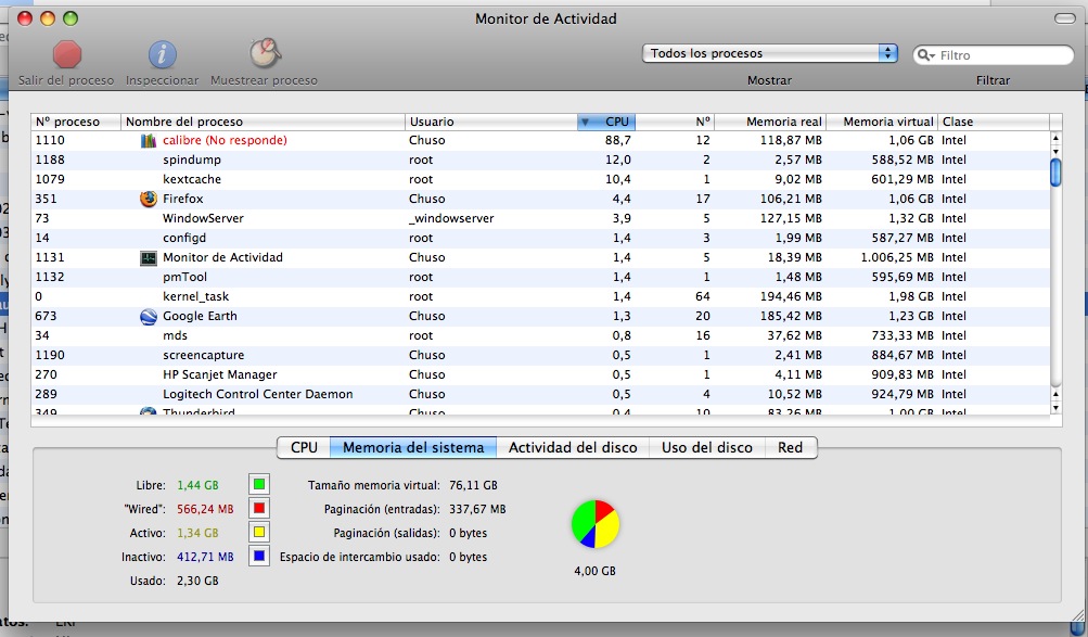

More data
Attached Activity monitor capture, open files+ports plus process sampling while hung ......
Hope this could help

The only thing I notice is that the Virtual memory requirement for Calibre seems insanely high. Not quite sure what this means though I guess it could be something to do with the fact that your are running on OS/X?
I dont think it could be because OSX. It was working flawlessly for months, until this problem arised ......
Anyway, thanks a lot for your comment.
