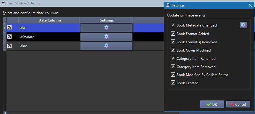

You might want to consider using the Last Modified plugin.
This is a must-have plugin. I recommend setting at least a Last Action column.
I have also 'favdate', which updates whenever I add a book to Favorites (yes/no column), and 'lac'. The 'lac' is Last Annotation Count date, which sets a new date whenever my annotations count changes for a given book. (the annotations count refers only to the calibre viewer highlights and annotations)
Name:	MWSnap 2026-06-18, 09_00_22.png
Attachment 223931
I love the idea of this, and I have installed it, but I haven't yet found any Instructions for the Tech Illiterate, so I'm going to be a while messing with it. (If anyone knows of any instructions like that, please link me!)
