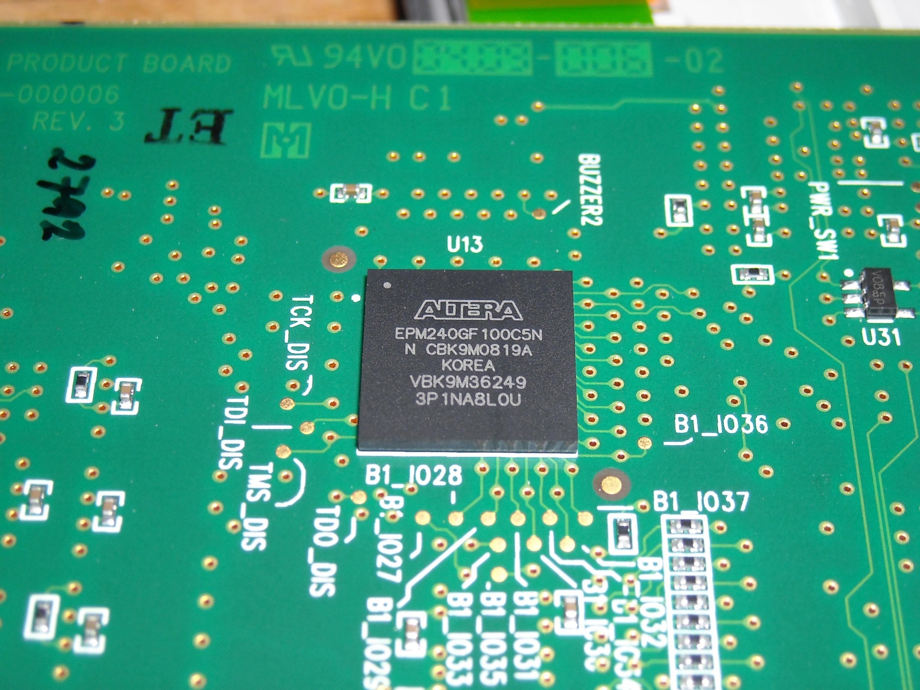

kleykenb, could you please repost a hirez picture showing chips U13 and U17 (or at least their part numbers) ?
Better picture of U!3 in attachment.
greets,Benny

Old 05-17-2009, 04:29 AM   #14
elbastorius
elbastorius began at the beginning.
Posts: 3
Karma: 14
Join Date: May 2009
Device: dr1000S
Kleykenb, great pic ! Thx.

Kleykenb, just a few more observations:
- when looking harder on the U17 region I suspect now that it is an empty placeholder. Is that correct?
- there is a region (delta chip side, when delta chip is up and right, then the region is immediately above and including the usb connector, and streching to the right cn10 cap. sensor stripe connector) that is not covered by any hirez image. There are a couple of ic-s of interest.
- the picture showing U14 is out of focus. U14 should be the mcu chip, so could you post the type number of it.
I'm bothering you with all these questions just to be able to figure out somehow wheter the hardware or the power mgmt. software implementation is the cause of the sad fact that the device consumes more than 100 mA when in sleep mode (which figure is really weird when taking into consideration the other fact that the device consumes only approx. twice as much when not sleeping and idle).
Thx in advance.
