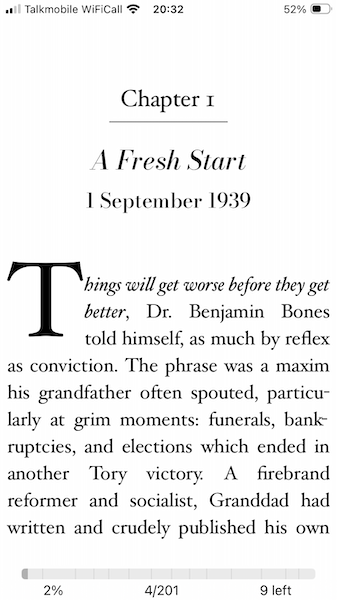

The rendering of drop caps at the start of chapters could do with some improvement. For some reason several books I've read recently have had Drop Caps, and justRead.app's rendering isn't as good as, say, calibre's.
These are all with publishers' style enabled.
Drop Caps is really rather hard to do sensibly, and I don't know what CSS these books have used, but I attach scrambled copies.
For "A Sorceress comes to Call", the two line drop cap is rendered as a raised cap instead.
For "Bones in the Blackout" the three line drop cap looks about the right size, but the baseline is wrong.
For "Foundryside", the three line drop cap is also about the right size, but with the wrong baseline, and the initial letter colour choice isn't obeyed.
I attach screenshots from justRead.app 1.9 and calibre 8.16.2

Hello Paul, so this is fixed and looks like this:

I added a little more space after that drop cap letter, to make it 'nicer'.
Will be in next update with Calibre Sync and OPDS.
