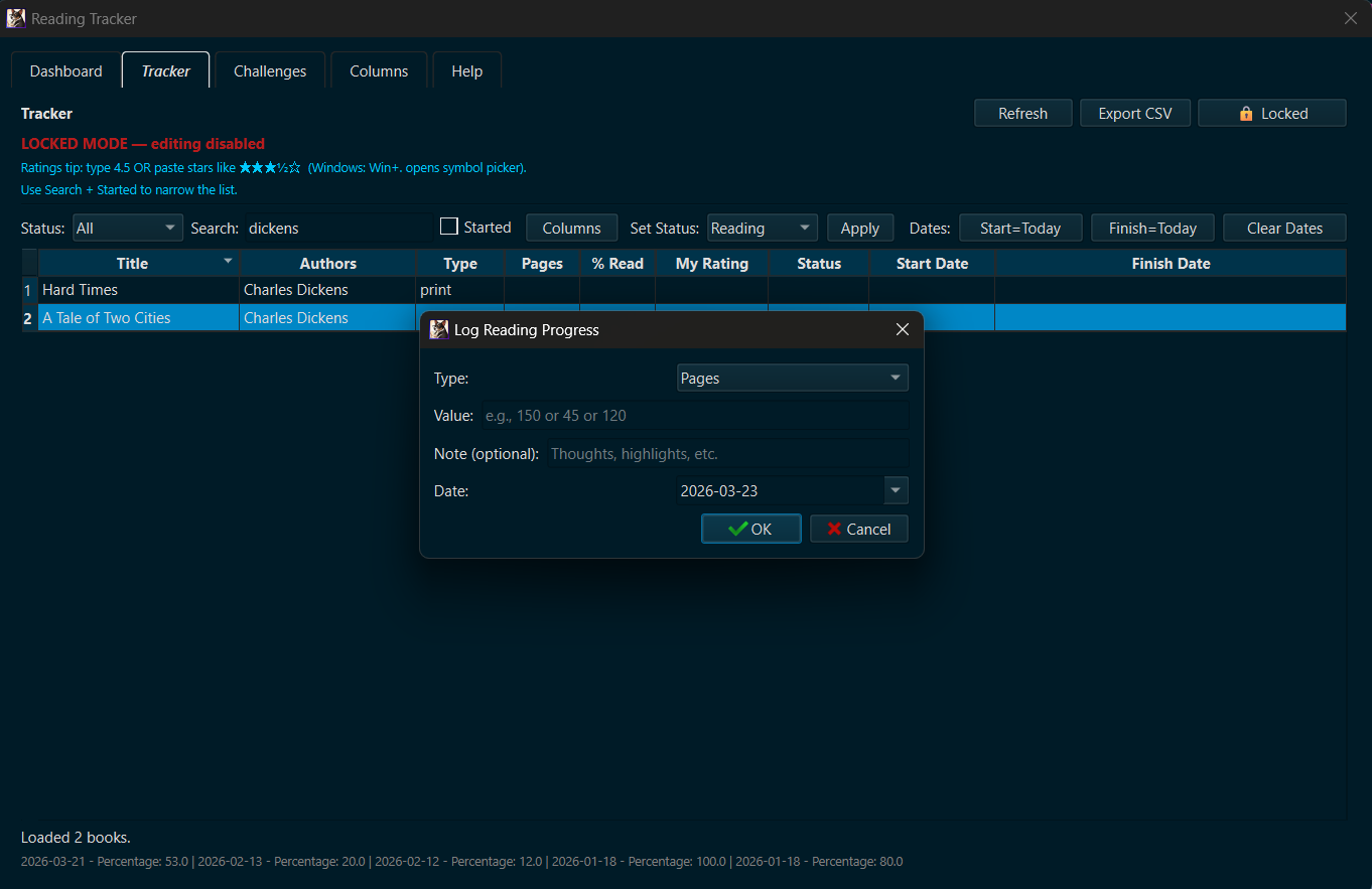

Have had an opportunity to squeeze come more changes to the tracker. Added functional tweaks as well as a Challenges tab. You can select specific books from your library to add to a challenge. Some new features: reading streak, import, export, drag and drop challenges, click book to go to the book detail in Calibre, local Ollama AI support if you have it installed (it is not required and can be hidden from view).
At this point what I need to know is if users would be fine with a stand-alone plugin that does not conveniently write to your custom columns. Reason being, it cannot support all possible custom columns and parse the data needed for the dashboard statistics. Where would still be interaction with the library, eg clicking a book in the tracker would take you to the book in the library.

Version 2 up for testing.
I strongly recommend installing on a test Caliber (portable works well) or back up. Keep in mind I am not even amateur rank.
New:
Challenges tab, interactive with your library. Reading streak for for the daily readers. For the anti-AI folks, Ollama will not run unless you install it. You can hide that panel. For those who want to try it, phi3 model works well enough. If you need help on it, ask.
Tracker tab with reading journal, improved review writing, interactive with library. Right click to see your book in the library.
Colors: Tweaked this to remove hard code colors, so now it matches custom palettes.
This was all in development when the last version was released, so certain features were not yet implemented.
Columns: Tried half a dozen different ways to remove reliance on columns and it is a bear. You lose interaction with the library. In that sense it would be like using Openreads tracker app but as a Calibre plugin. A hybrid with columns for those who want it and no columns for those who don't, is mayhem. Anyone with more coding brains than Chatgpt, feel free to suggest ways to tackle that beast. Otherwise, highly recommended:
https://www.mobileread.com/forums/sh...d.php?t=372614
Translation-friendly coding: Very important, still in the works.
Still have some more tweaks to do. More stats if possible.
