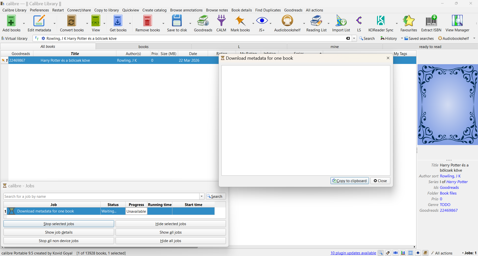

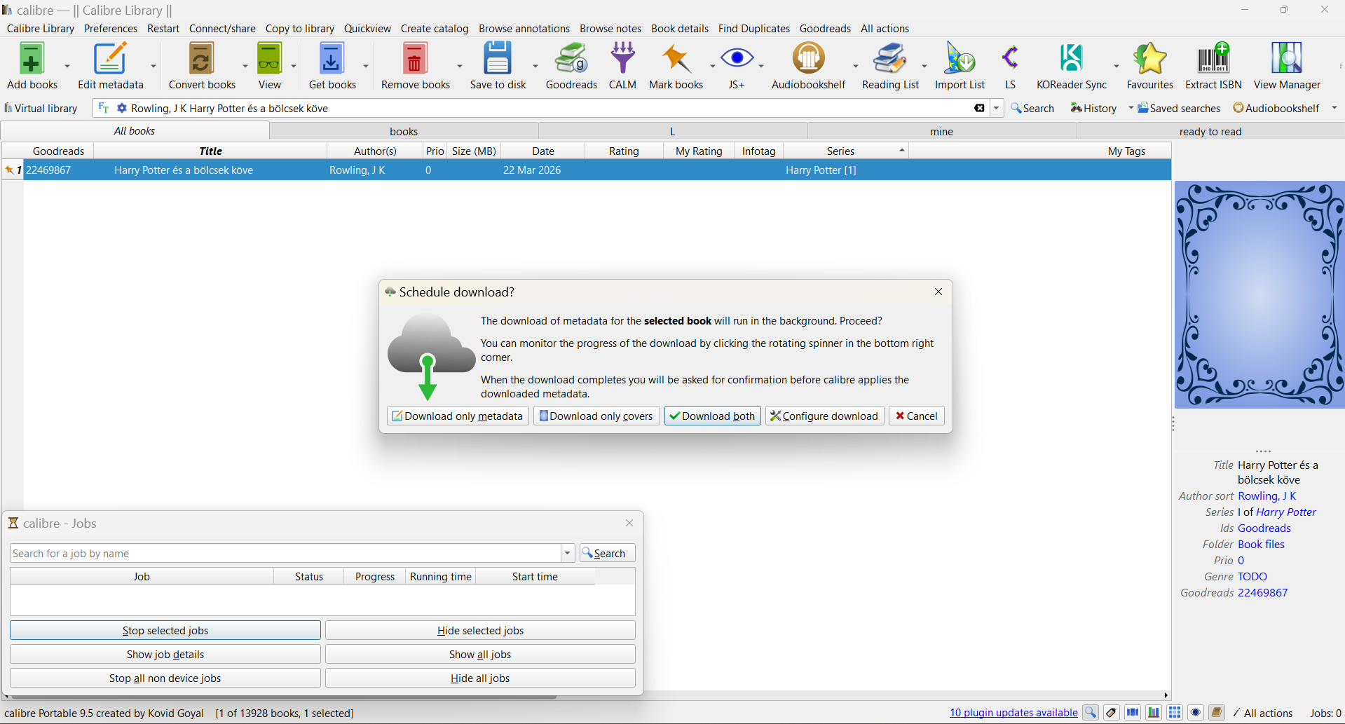

Downloading bulk metadata - even for one book - keeps hanging. I am able to download metadata when I'm editing the metadata.
I restarted calibre in debug mode, but there was no printout at all during bulk download. I already waited over 10 minutes to download metadata for one book.
I also reduced the metadata sources to only one (I tried Google and Goodreads as standalone source) - but it worked as mentioned above.
Starting Bulk Download job
Job is "Waiting", but I could wait for an hour and wouldn't happen anything.

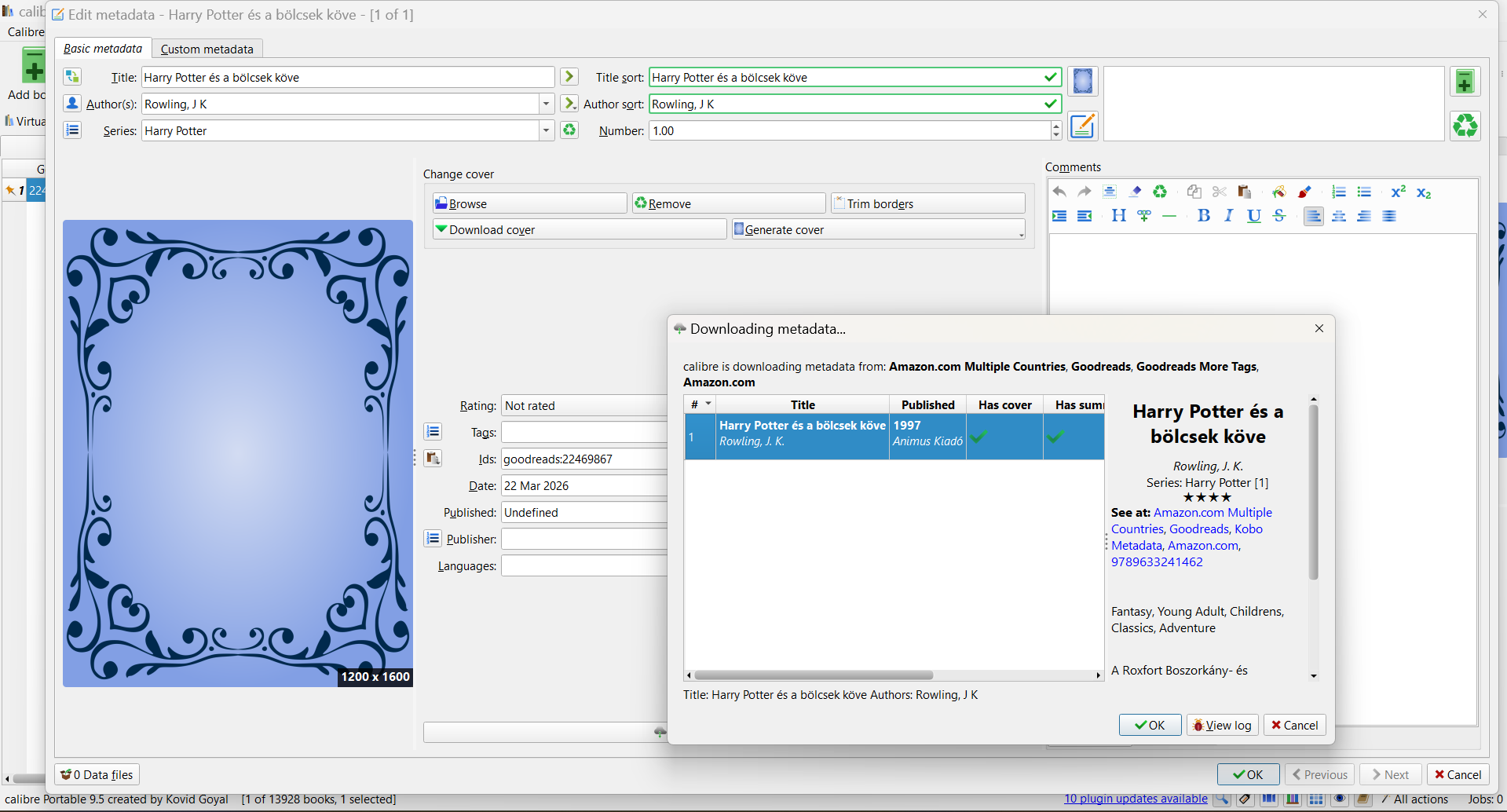

It works inside Edit Metadata.
