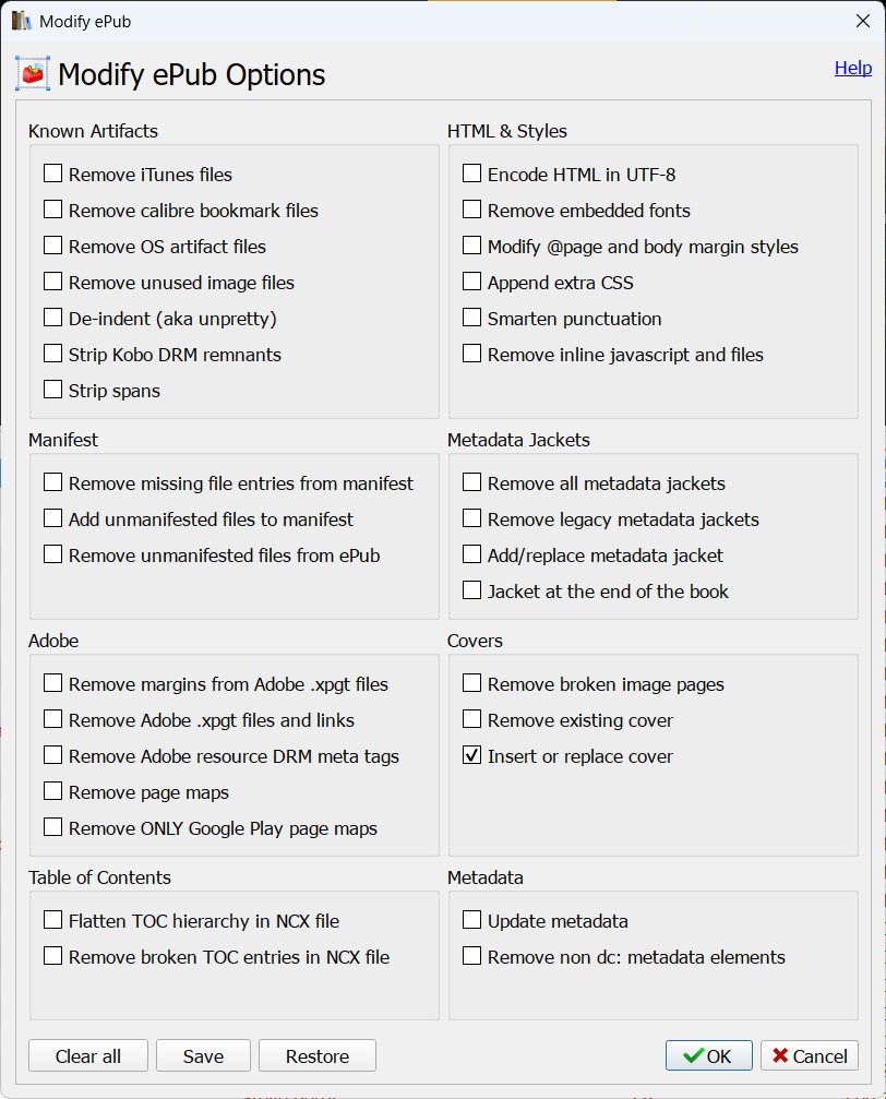

I have a very simple solution that will work very well. Use the Modify ePub plugin. There is an option to insert or replace the cover. IT does as little as possible to change any of the code. See the screen grab to see what the option is you'd need to select in order to fix the cover. You can do this for multiple ePub in one go. It works very well. It will keep the correct aspect ratio. This is the best solution for updating the cover for ePub.
Attachment 221898
Thank you very much Jon. I think you must have been writing this as I hit 'send'... so, problem solved, but appreciate very much your help.

Modify ePub is a very excellent plugin. I use it a lot.

You do not need to convert ePub > ePub. Retail ePub has the cover at the correct aspect ratio. However, if you get a generic cover or want to change the cover, use Modify ePub by first replacing the cover in Edit metadata.

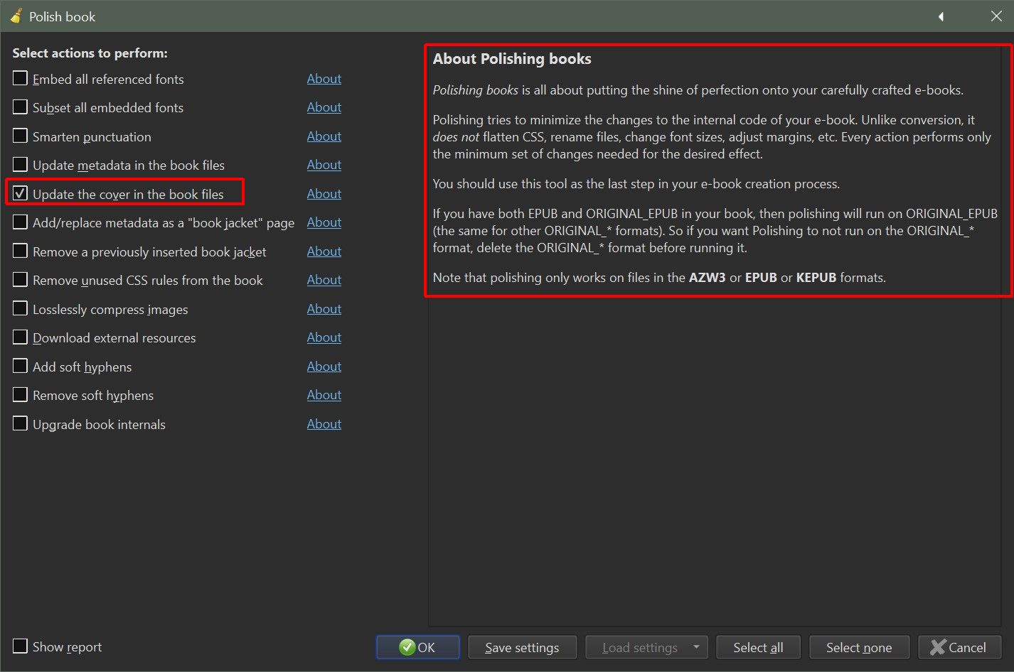

Old 03-19-2026, 06:17 PM   #14
Posts: 22,816
Karma: 34252730
Or use calibre's built-in Polish function - press 'P':
Attachment 221899
Heck no. That changes more code then Modify ePub. Modify ePub is designed to change as little code as possible.
