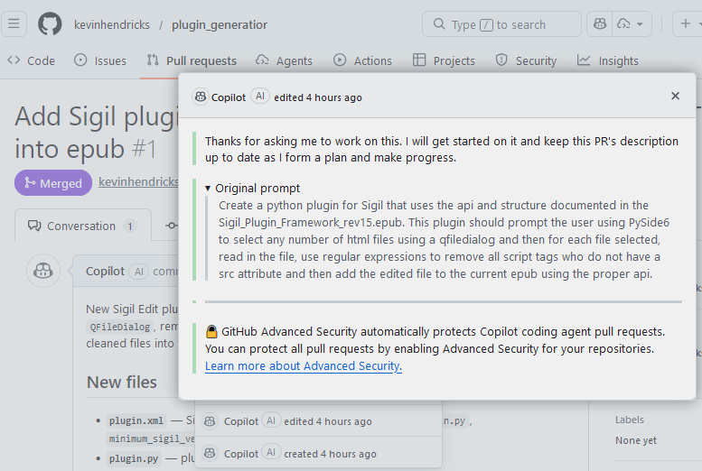

Hi All,
I wanted to pick people's brain about using the Claude AI to create a working Sigil plugin. Obviously I could do that myself easily but I wanted to see how hard/easy it would be for someone without any python coding experience to actually create a simple plugin using Claude.
So I had some questions:
1. Do I have to pay for using Claude to make a simple plugin for Sigil? Do they have any free subscriptions for OpenSource developers?
2. Have you tried something similar with Claude or OpenAI Coder?
3. If so, how good or bad was the attempt and how much manual work was needed to actually get things to work.
As an example project, I want to try using Claude to code up a Sigil edit plugin to allow a user select one or more html files and have them be read in (with all supporting resources via their links) and pre-process each html file by removing all <script> tags that do not have a src attribute.
This is really trivial to do in Sigil with PySide6 and regex, but I wanted to see for myself how this is done and what the state of the art can accomplish right now and as a learning experience for me to see how quickly I will become obsolete!
So happy to hear any thoughts, suggestions, and hints on how to go about doing this myself so I can see how things turn out. And I have enough plugins of my own that I can use them to "train" Clause if needed, and I will NOT give it anyone else's code, only my own to learn from if needed.
So if anyone has any tips on how to go about this on Linux, I would really like to hear your thoughts?
Free subscriptions are available. But you'll need to sign up for a free account.
I tested both Claude and Perplexity. They can both generate simple plugins with minimal corrections. BeckyEbook also experimented with this.
It can be helpful for parts of a plugin. (I only used it for a particular function that I had problems with.)
This kind of a simple plugin should be doable with Claude, Perplexity and possibly other AIs
I tested this with Claude. The first version was this:

It hallucinated quite a bit. When I pointed out that Sigil uses bk not bc it slightly changed the code and came up with:

@KevinH: You will likely already have free access to claude (and other models) via GitHub copilot. And yes this kind of thing will be fairly trivial for copilot to get almost entirely correct in agentic mode. And you dont need to install anything on your computer to use it. Simply go to https://github.com/copilot and use the chat interface to ask copilot to send a PR or generate code whatever suits the use case. A few sentences (3-4) of instructions will likely generate largely working code. I'll leave you a couple of examples of doing this via PRs in calibre. Note that though the PRs are marked closed they were actually merged (I squash the commits and merge as a single commit).
https://github.com/kovidgoyal/calibre/pull/3023
https://github.com/kovidgoyal/calibre/pull/3024
https://github.com/kovidgoyal/calibre/pull/3026

Wow I am astonished! I created an empty repo in my personal github account just as a playground: (notice I could not spell generator correctly but !)
https://github.com/kevinhendricks/plugin_generatior
And used the initial following prompt:
Create a python plugin for Sigil that uses the api and structure documented in the Sigil_Plugin_Framework_rev15.epub. This plugin should prompt the user using PySide6 to select any number of html files using a qfiledialog and then for each file selected, read in the file, use regular expressions to remove all script tags who do not have a src attribute and then add the edited file to the current epub using the proper api.

So after accepting their initial attempt, I added the Sigil_Plugin_Framework_rev15.epub file to the repo and then opened a second agent request:
Fix plugin.xml to use only the allowed tags as described in the #Sigil_Plugin_Framework_rev15.epub document.
It came back also instantly with a fixed plugin.xml file. From looking at the agent thread it clearly unpacked the framework epub, read it in, identified the part about the plugin.xml tags in the api and identified the incorrect tags all itself. The ability to follow an api even one documented in an open structured epub simply amazes me.
https://github.com/kevinhendricks/pl...8-4019c89bea1b
I then built and tested the resulting plugin (zipping it by hand) and it actually worked correctly.
I never actually touched one line of code and instead just gave commands to fix errors in the plugin.xml file based on the api docs alone.

Copilot does store your the exact text of your request but it was not easy to find (you have to look in a PR's edit history) so I quickly learned to copy each one of them to a separate text editor for safe keeping).

I am truly astonished.
For some reason Copilot does not store your the exact text of your request (so I quickly learned to copy each one of them to a separate text editor for safe keeping).
Yes, it's amazing.
BTW, I can see the original prompt under PR edits:
Name:	MWSnap 2026-03-10, 16_47_10.png

Originally Posted by Comfy.n View Post
Yes, it's amazing.
Attachment 221646
Wonderful. I will edit my post to reflect the actual wording for both.
