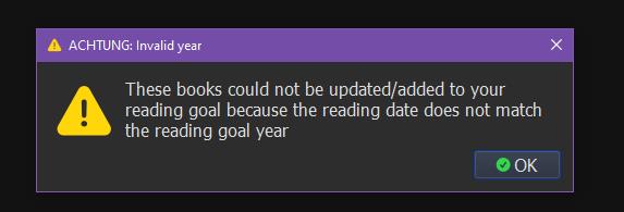

I'm sure we've been through this before, but I can't remember.
I wanted to have a look at RG and this message showed up. I started reading the book last year, but haven't finished it yet. The strange thing is that the message is only appearing now and not the days before (IIRC).
Calibre 8.16.2
RG 2.0.7
Attachment 220162
Calibre 8.16.2
RG 2.0.7
What this means is...
It's now 2026. You last read date in calibre is 2025. What you cab do is change the date to 01/01/2026. Then you can add the book to your list. And once you plug in your Kobo and update the resting stats after having read that book, you'll be correct again.

Shouldn't they be transferred automatically? I also have currently reading books from 2024 and I can't remember this message in the past.

I have added it as JSWolf described with a new date and got 2 entries with 0% progress for this book. Then I deleted it and added it as a new book with the old 2025 date. Since then no problems anymore.
Attachment 220162
Calibre 8.16.2
RG 2.0.7
Jon is right. When the plugin moves your unfinished books to the new year's goal, it creates an expected inconsistence with the dates. The first time your interact with the plugin it will show the offending books. Just change their reading date to match the new year.
And yes, they are transfered automatically if you check this option, but the plugin does not change your calibre library, and that's what causes the inconsitence. This is a conseguence of the developing choice to never change the calibre library.

File "calibre_plugins.Reading_Goal.main", line 292, in manage_reading_goal
self.custom_challenges(db, data)
File "calibre_plugins.Reading_Goal.main", line 2112, in custom_challenges
d = CustomChallengesDialog()
File "calibre_plugins.Reading_Goal.main", line 1712, in __init__
Dialog.__init__(self, _('Custom challenges'), 'plugin-reading-goal-challenges-dialog', parent=tool.gui)
File "calibre/gui2/widgets2.py", line 272, in __init__
File "calibre_plugins.Reading_Goal.main", line 1763, in setup_ui
if 'challenges_dict' in goal_data[year]['summary']:
KeyError: 'summary'

Name:	Bildschirmfoto 2026-01-25 um 12.33.19.png
ID:	220494   Click image for larger version
Name:	Bildschirmfoto 2026-01-25 um 12.34.21.png

Originally Posted by Reader4106 View Post
Regarding the issue with defining "Challenges":
Here are two screenshots again:
1: Accessing the definition
2: Error message
And here is the copied text of the message:
And once again, thank you for your great work on the plugin and your efforts.
Did you manually edited the JSON database file? You are missing the 'Summary' key for some year. Anyway, I added a check so it can rebuild the summary in case it's missing.
Check the attached version. (The was a bug. I'll add it again after fixing.)
Last edited by thiago.eec; 01-26-2026 at 10:48 AM. Reason: The was a bug. I'll add it again after fixing.
