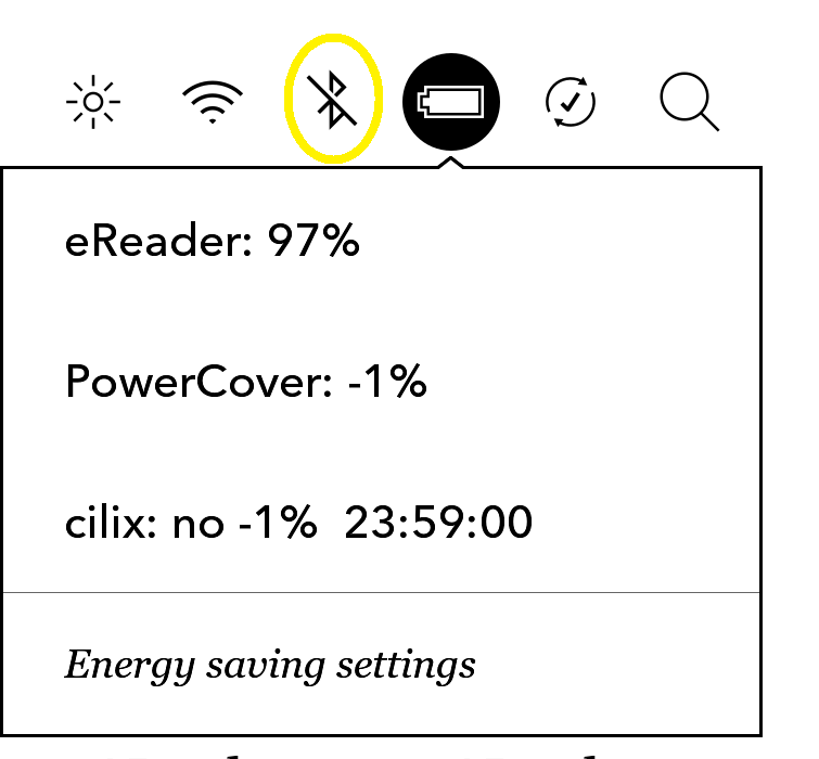

Can there be a patch to remove the bluetooth icon from the home screen?

Considering how long the x.yy.23552 firmware has been out? Assuming you mean the icon that I've circled in the attached image? Why not simply revert back to the 4.42.23296 revision if seeing that icon bothers you that much? It's not as if you are going to gain any useful space by removing that icon.

Oh no! Your Power Cover is at -1%! It's slowly draining the life out of your Sage!
Yes, I could do that. Until the next time it updates and puts it back. It's just annoyingly phone-like, seeing it there!
It still strikes me as a bit humorous that a Sage without a power cover shows that line when you enable developer mode. Personally, I prefer the 3rd line for the stylus when one is not attached.
