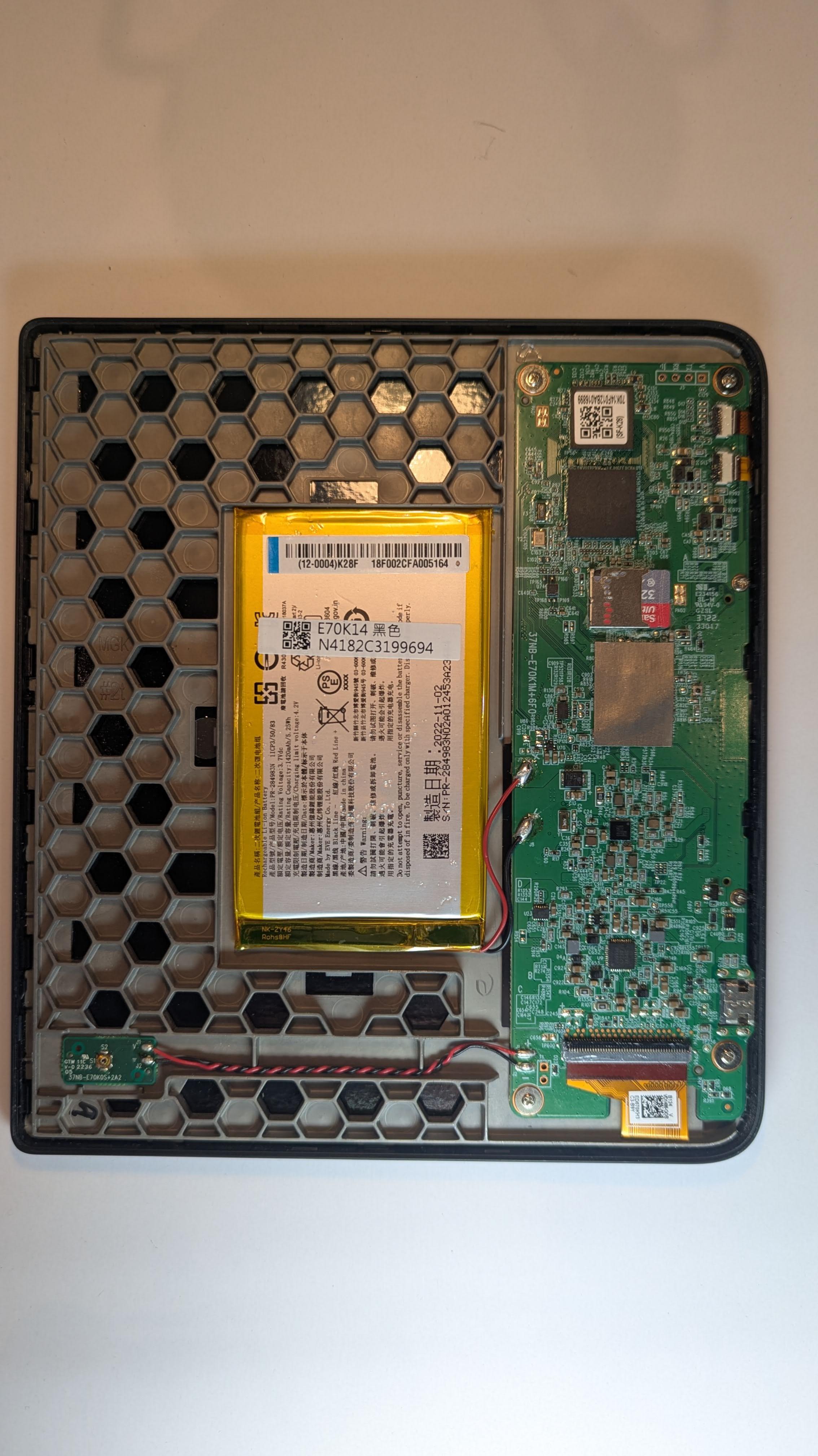

This is a bit of documenting my process that other may find interesting. If you've got more ideas on what to follow up on as well I'm keen to hear them!
My Kobo Libra 2 (N418) got stuck in the boot loop after uploading an epub to the device via a USB cable. Resulting in a blank screen, and continuing flashing indicator light.
After posting here I uploaded three different revisions of the firmware to a new uSD card using balenaEtcher, I wasn't able to find a particular revision label on the board so am trying all three. The board has E70K14 and the serial number starts with N4182C.... Maybe that's E revision...
Most of these I was testing by holding the power button, the indicator would stop flashing, go solid on then solid off before starting to blink again.
kobo_libra2 4.raw - On this revision of the firmware after the indicator going solid off the front backlight would flash on then off before the continual blinking began
Rev E & Rev G - Here the backlight didn't flash on (it also wasn't as consistent going into the loop? Sometimes required power to be attached)
I checked the battery voltage after this and was able to hold steady 3.8-3.9v without external power attached and after looping for a while, I concluded it's likely not the battery.

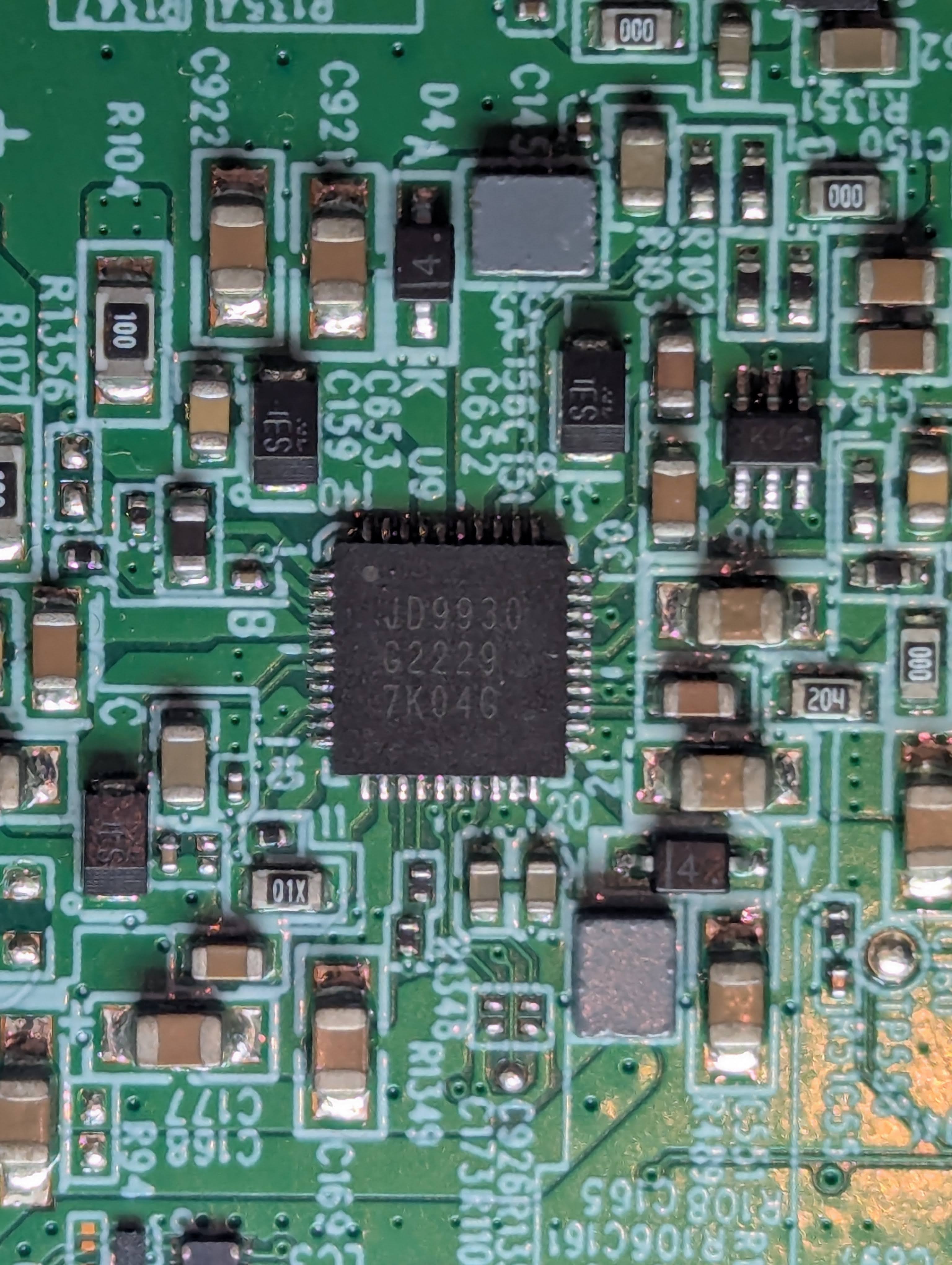

After this I noticed the serial output on the device and attached a USB Serial device. Each of the revisions of the firmware gave a pretty similar output. Here was the output for Rev E firmware.

sy7636 1-0062: Unable to write SY7636 reg4 via I2C after waked! retry ...

From this, it looks like the uSD card is being read fine, and the issue is stemming potentially from the SY7636 component (or potentially the I2C bus is busted?). Unfortunately I wasn't able to find a SY7636 device on the board, underside included.
Next steps I wanted to try out
  • Reach out to Kobo and ask what component SY7636 is expected to be on their revision
  • I saw in the logs the ability to stop auto boot, might be interesting to jump into that and see if any more details can be included
Does anyone have the logs from a clean boot sequence? It would be interesting to compare them, unfortunately most logs I'm seeing are ones with issues.
Do you make anything differently from the logs?

Linking a few things together here I think the firmware revision is likely wrong here for me. The power management for the screen looks to be a JD9930 instead of the SY7636 that the firmware is looking for. So something isn't aligning there.
However all three revisions offered all seemed to try and communicate with a SY7636 device.

Hi,
I'm not sure if this will help you, but I sent you a private message with an image of the SD card from the 6F0 motherboard.
https://ibb.co/0y303tHX
https://ibb.co/hJTmF87M
Waldy is offline
Old 11-15-2025, 05:39 PM   #4
LukeLibra
LukeLibra began at the beginning.
Posts: 6
Join Date: May 2025
Legend, that's done it!
Appreciate the help, I thought it was going to be a much more in depth adventure
LukeLibra is offline

Originally Posted by Waldy View Post
Hi,
You might want to share that with DNSB
PeterT is offline
Old 11-16-2025, 12:52 AM   #6
Posts: 50,746
Karma: 178402706
I thought I had already gotten that image from Waldy but have asked for the image to double check. It should be the one that is labelled as Kobo_N418_Libra2_6F0_rev_F.
A few months ago I sent you an image of Kobo Libra2 with motherboard 37NB-E70K1M+6E0 PCB_LVL='E' and also Kobo Nia with motherboard 37NB-E60U20+4C1 PCB_LVL='B'.
Today I sent you a Kobo Libra2 image with a 37NB-E70K1M+6F0 motherboard PCB_LVL='F'.
I still don't understand what we mean by "revision" Using the Kobo Nia with a 37NB-E60U20+4C1 motherboard and PCB_LVL='B' as an example, is it rev C or rev B?
For those requesting images, it's highly recommended to specify the motherboard version; you'll need to open the back cover anyway.
I should refer to that Nia revision as a rev C to be consistent with the naming convention that has been used with the Kobo Libra 2 where we use the letter from the printed label as the version though the Libra 2 seems to match that to the PCB revision.
And yes, it is good when for those Kobo ereaders with multiple versions, the requester includes the motherboard version.

I had originally reached out for images for N418 in May, but this was a bit before you had submitted your image to DNSB. And only just had time to relook at why the firmware was failing for me.
Thanks all for your help!

Did you get your device working again?
The pinout of both mentioned chips is different, perhaps a software or hardware fault that's causing the need to reflash, corrupts os device settings resulting in initialization of a different model.
it also supports dfu, usb device id in dfu mode is 18d1:0d02, flashing without removing the sd card should be possible.

Very cool, wasn't aware of the DFU capabilities, will try that next time, thanks!
The device is working again. From start of the issues to now the happy path fix was to replace the uSD card with a new one, request the latest firmware, and reflash the firmware onto the new uSD and reinsert.
