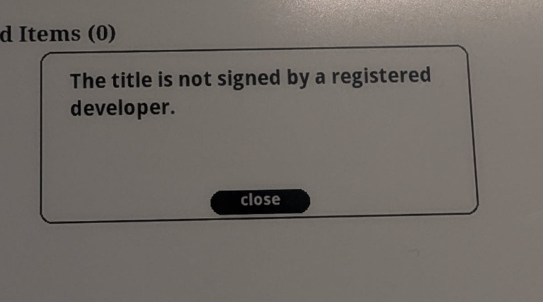

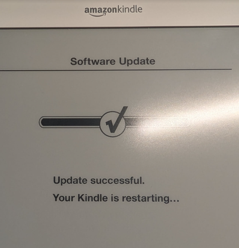

I can`t make it work on Kindle DX, getting The title is noty signed by registered developer
I have installed this MKK update 2x already
Update-mkk-20250419-dx-B004_keystore-install.bin
I`m probably on a wrong date since I have to run the setdate update everytime I loose power to the device. Would wrong date be an issue?
Would you know where I can find older KUAL versions to try go back?
( it does work on K3G )

Originally Posted by vendo232 View Post
Team
That keystore update and the latest version of KUAL are broken on Kindle DX.
You'll need to use an old version of KUAL and the old MKK from the first post in the snapshots thread. Here's a version of KUAL that should work: https://storage.gra.cloud.ovh.net/v1...0250103.tar.xz
The old MKK keystore expired in April 2025, so make sure to keep your Kindle's clock set to a date before then.
Nice to see you again SpartanHeavy. Thank you for the advice. Rolling back worked as the setdate bin file is in the past.
