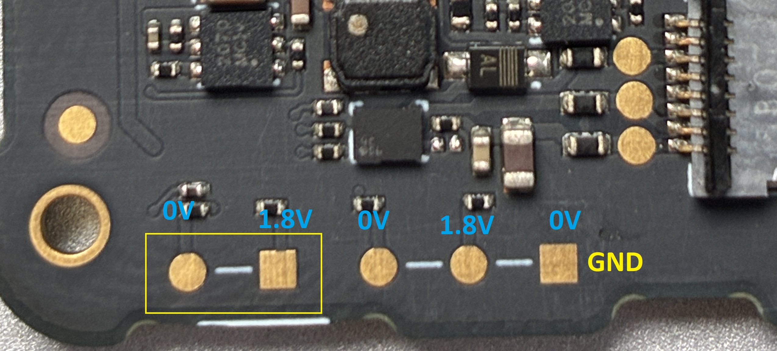

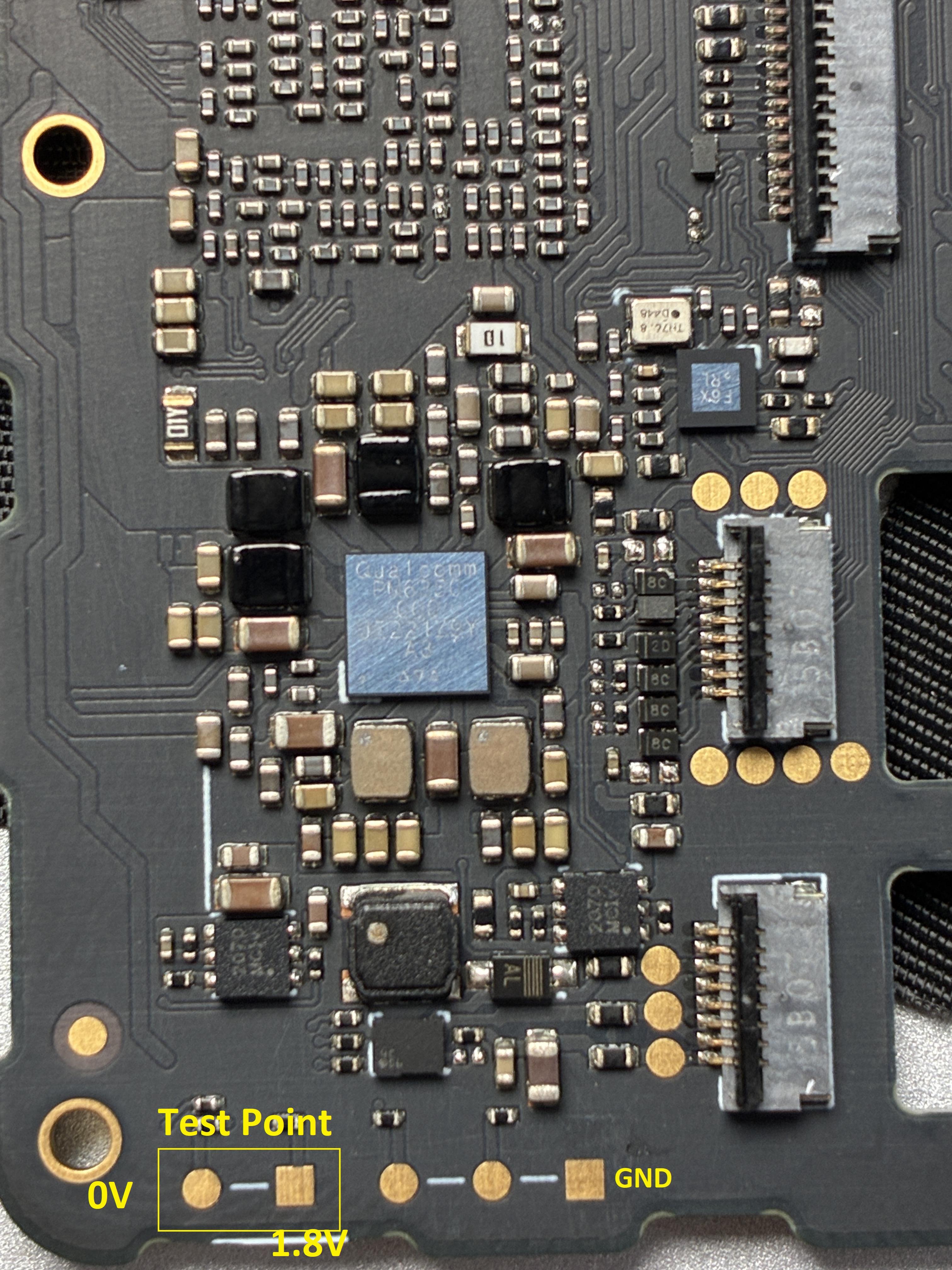

1.8V is the steady voltage source.
0V is a GPIO input with an internal pulldown resistor to ground.
This is true for all Qualcomm.
If you have a "diode test" mode on your DVM:
You can connect black to a ground (like a tin shield).
You can connect red to the "0V' point.
You can do a reset with the power button or adb reboot or however.

Thank you Renate
Those was the correct test point. I can boot to EDL mode successfully.
