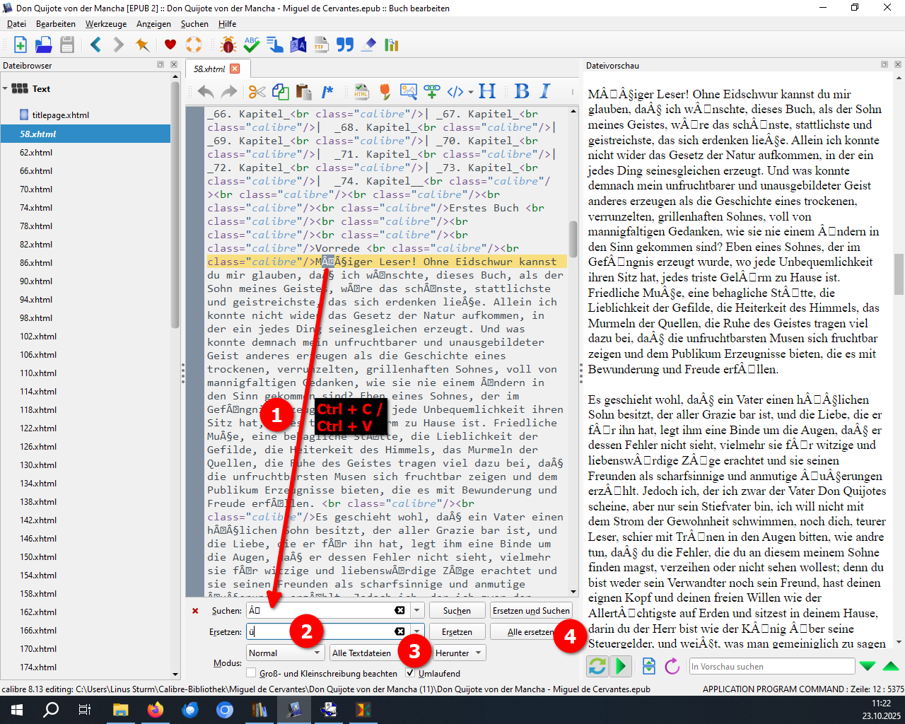

Old 10-23-2025, 06:48 AM   #73
Animyos Fox
Animyos Fox began at the beginning.
Join Date: Oct 2025
Method for dealing with Unicode characters
Originally Posted by svru View Post
Hello mscott161,
your greatful tool "Convert IMP" doesn't work with german umlauts! That's very sad for my german eBooks. I am a German - sorry for my bad english possibly.
Would it be possible to make this possible?
I find no way around german IMP files to use in Calibre.
Calibre represents instead the German umlauts are any special characters.
Sven
Originally Posted by GrannyGrump View Post
The text extraction pulled out the text well enough, but apparently cannot deal with unicode characters. Lots of question marks/null glyphs for curly quotes, mdashes, diacritics, etc. I don't know if the HTML extraction would have better results, because it is disabled and not usable.

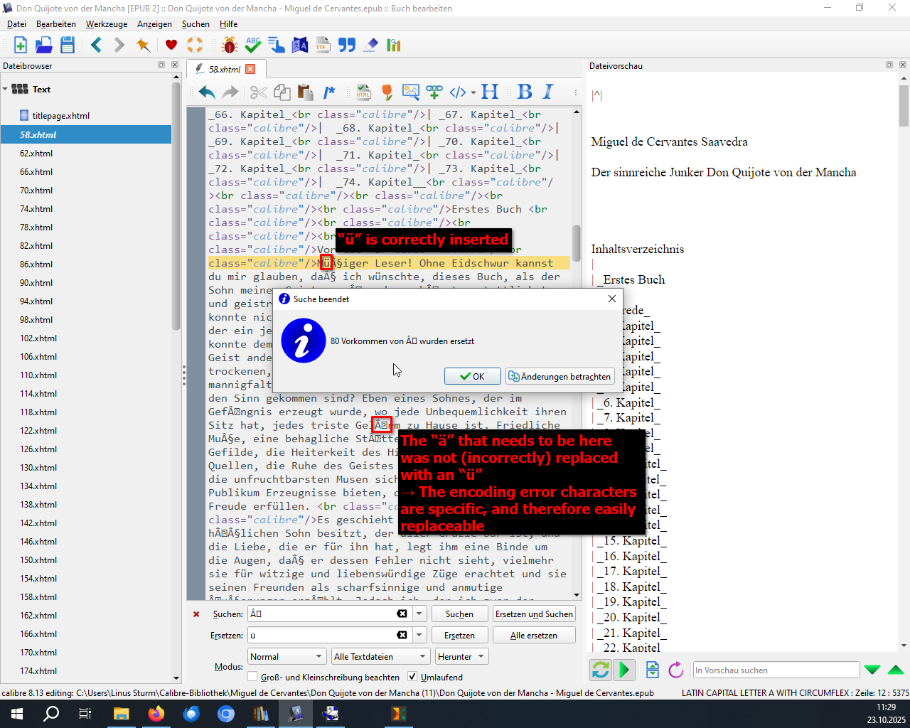

I have myself tried to convert an .imp ebook with both umlauts and accented vowels into an .lrc one using IMP, and run into the same problem. However, I found a way to (relatively) easily fix this:
I first converted the .lrc to .epub using Calibre (as my end goal was to have the ebook in .epub format). The file contained the special characters the others mentioned. Through comparing it with the original .imp file I had opened in the preview window of eBook Publisher, I could match the special characters with the original umlauts / accented vowels:
I can then copy the respective sequence of characters representing, for example, the “ü” and paste it into the Search > Search/Replace menu (1); set replace to the original character (in this case “ü”; 2); set the range to all text files (3); and replace all (4):
After having done that, you can immediately see that only the sequences of characters representing “ü”s have been replaced:
When you have replaced most of the erroneous special characters, the remaining ones can get quite sparse, so to say . To find the remaining ones, simply search for Â(without replacing anything, just search), as all of the sequences (at least in my case) contained this character as the common denominator, while the second one varies.
I hope my method can be helpful to you (in case it’s even needed anymore, as this thread is quite old …).
