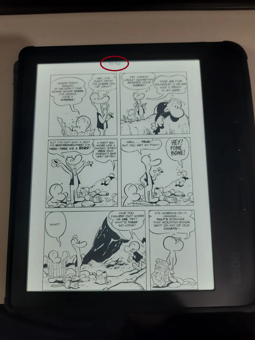

Anyway to crop the subtitle at the top of the pages?
Kinyas is offline   Reply With Quote

Increasing the cropping power might
Otherwise maybe crop it outside of kcc
