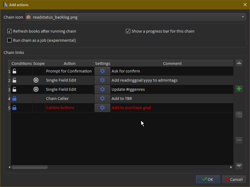

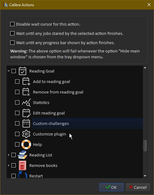

Odd side effect of the last one: Add to Challenges disappears until you open the menu. This affect Action Chain.

This has nothing to do with the recent change. To be honest, the add/remove challenge menu entry was always created when you first interact with the plugin, because the library_id is not yet available at calibre initialization. Maybe when you first created the chain, you had opened Reading Goal before. Have you recently changed the chain or it just stoped working?
Check the version attatched. See if works now.
@Feoras
I also increased the point size in the daily graph, so it can be seen when you have a point in a straight line. I guess this could solve your problem without a new type of graph.
