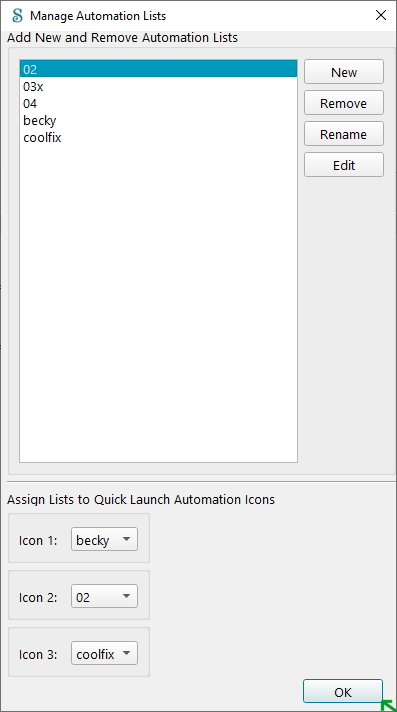

In Windows, the OK button is located in the lower right corner, which is somewhat inconsistent with other Sigil windows.
ID:	218630   Click image for larger version

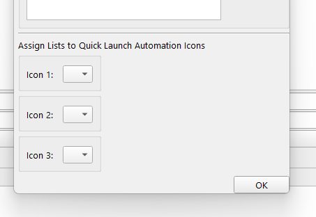

@BeckyEbook what did you mean about adding a space above the Okay button in the ManageAutomationDialog? Please see my screenshot below. There appears to be a reasonable distance to the Okay button (at least on a Mac).
On Windows 11, the OK box is in the bottom corner touching the lines.
Name:	Screenshot 2025-10-14 162234.png
@DNSB and @BeckyEbook
Thanks for explaining. I think that is a minor change to remove the margins in the ManageAutomation Dialog form ui file. It uses margins that were left over from Sigil Preferences that imbed themselves in a larger QDialog frame.
I will try tweaking those values tomorrow.
Same in my MacBook. Works fine, but would be aesthetically more pleasing if it were moved a tad to the left to be in vertical alignment with the New List and Remove buttons.

That "okay" button will always be in the right corner on macOS (it is the spec) so changing the dialog width will always change it. So it can't be aligned it with any buttons as those change positions as well. I will improve the margins around it though.

Okay, I removed the margin limitations in ManageAutomation.ui so that the "okay" button is better placed.
Then I pushed all of the automation menu changes to normal Sigil master. This new feature will appear in the next release of Sigil.
