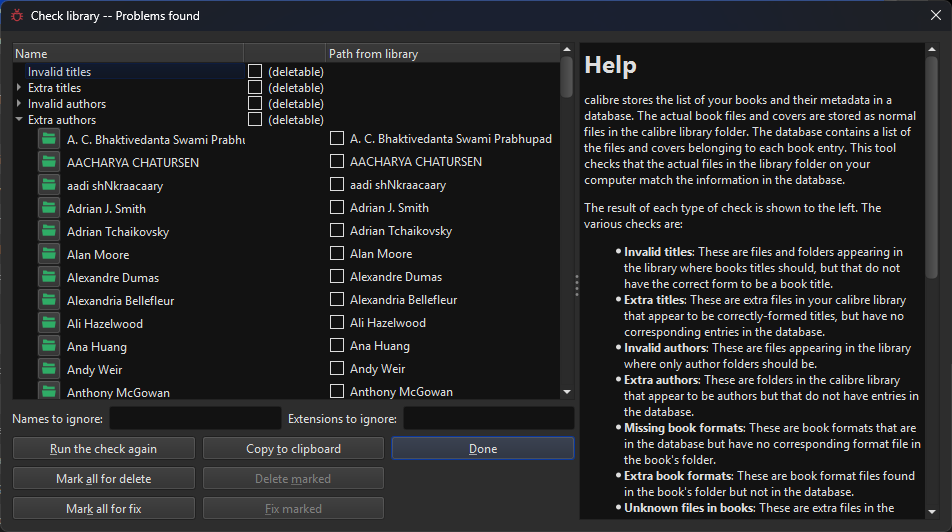

I was browsing books on my connected device (kobo) and clicked "Refresh cached metadata" after that I suppose something went awry (Inside calibre) and my on device (computer) library shortened from 248 to merely 39 books
then I ran "Library check" and it lists all the missing books as deletable

Tried restoring the library, but no use. All the "Missing folders" have calibre metadata file in them, is there any way to rebuild the database using it? I don't want to go through all the books and assign tags, status and new columns, and would like to avoid it if possible.
Also tried file recovery (thinking calibre should have deleted or edited the old metadata file) but that also resulted in nothing, there were no old metadata.db files in the directory

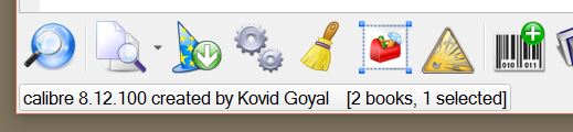

The most probable oopsie that I remember doing is clicking this button. I hadn't used it in the past, but yesterday I deleted two books from the eReader (First through calibre and then from the explorer) and clicked this button. It was after this that I noticed missing books

Yes, the Library (on my pc) got corrupted, this is the last button I clicked before it happened. It could have been for any reason (idk, not much experience with calibre, just importing, editing metadata and exporting), but this is the last thing I remember doing before noticing that books were missing.
It was fine when I was in the library view, then switched to the device view and clicked this button. I noticed that all the books on my eReader (in the device view) were missing that "in library" checkmark. So whatever went wrong, definitely went wrong when I was in the device view and not in Library view
