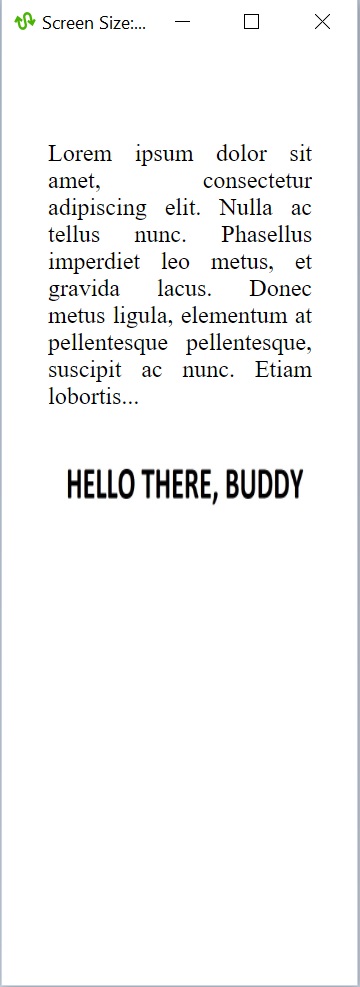

As I understand it, "em" isn't a absolute unit, it's a relative unit. So, I mean, I guess it's as natural as any other em value.
Regarding max-width, the issue is that setting it at 100% means that the image will appear to stretch vertically if the screen width is too narrow relative to the defined height. See the attached images: test1 has a viewing window that accomodates both the defined 4em height and the proportionally scaled width; test2 shows what happens when the viewing window is narrower than a 4em height and a proportional width would allow—namely, it preserves the height and squishes it width-wise to fit it all on the screen.
With "natural" height, I mean the height of the image if you don't specify any height. If it's smaller than 4em, setting max-height:4em will not do anything.
Not in Firefox, or in the calibre viewer, or in KOReader, at least with the attached test, as far as I can see.

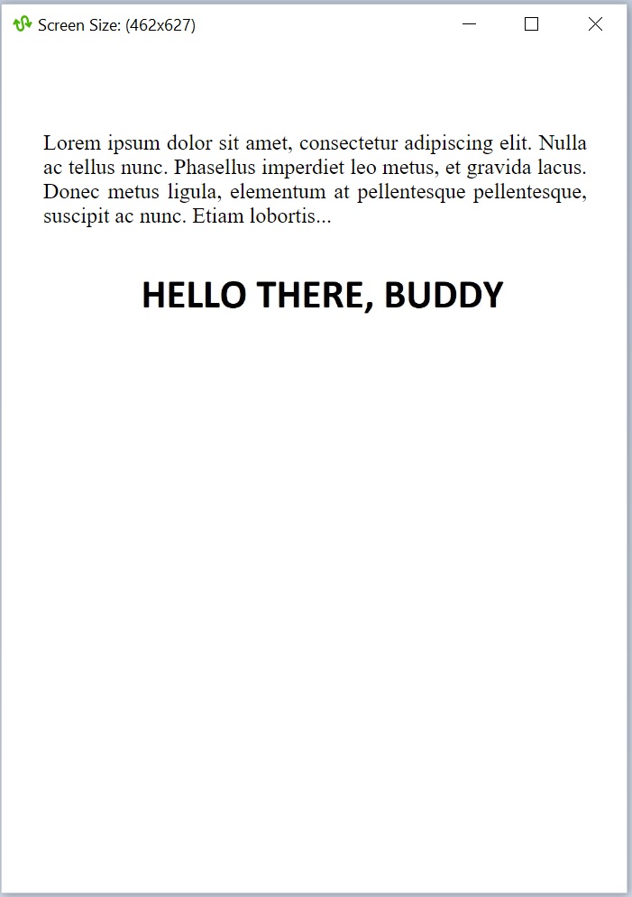

@Jellby - I think I'm seeing the difference between our two codes, and I don't really understand what the implications are:
Basically, in your test version the height is defined at the <div> level, not the <img> level, resulting in the correct scaling that you observed. I'm confused, though, why definiing the height at the <img> level would result in squishing, and I'm wondering if there are any other unintended consequences depending on which level the height/width values are assigned. Do you know?
EDIT: Welp, I've found unintended consequences...
Whatever protocol PageEdit is using to parse height/width values defined at the <div> results in the image going off the screen (see test3, attached).
And in the EpubJSReader Sigil plugin it cuts off part of the right-hand side of the image (see test4).

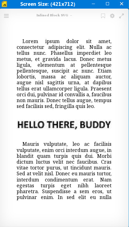

Well, you want a solution for epub2. With this restriction in mind, you'll need to use an SVG wrapper and assign it the "display: inline-block; width: 100%; margin: 1em 0; text-indent:0" properties. This seems to work:
Inlined_Block_SVG.epub
Crop to content the image before including it in the svg wrapper and use margins (or paddings) to add blank spaces. Of course, I set "margin; 1em 0" but you can set the values you want.
