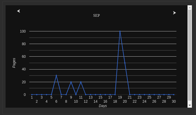

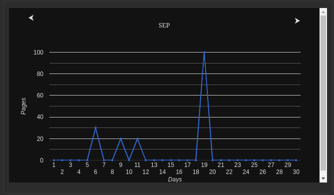

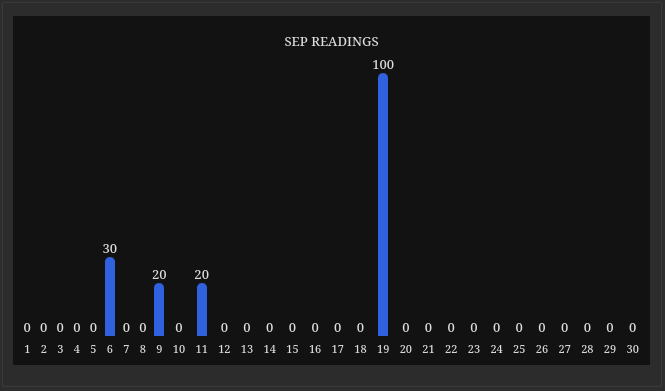

Thank you again!
It pains me to do one more feature request.
I would like the option to have bars instead of the graph for the daily display as well.
It probably was quite the effort to put the graph in, but the issue with the graph, in my opinion, is how days close to each other are not really well distinguishable.
E.g. on day 19 I read 100 pages, on day 20 I read 50 pages. Day 21 then 0 pages. For the graph, this one one straight line where you can easily miss the read pages on day 20. With bars, this is visible out of the box.
I hacked the get_month_html function to display a specific month for the attached demo screenshots.
I took some sample screenshots with the described example: day 19 100 pages and day 20 50 pages, or only day 19 100 pages - for both graph and bar.
This is how the function looks for testing:
            def get_month_html(self, _data: dict[str, dict]) -> str:
                # Bar model
                daily_bar = v_bar
                daily_page_count = self.daily_page_count()
                # Get a bar for each day
                bars = []
                for i in daily_page_count["sep"]:
                    bar = daily_bar.format(str(daily_page_count["sep"][i]), daily_page_count["sep"][i], i, "")
                    bars.append(bar)
                bars_string = ''.join(str(b) for b in bars)
                # Insert the bars in the html file
                daily_html = v_html.replace('<!-- Placeholder -->', bars_string)
                # Format html
                bar_color, text_color, background_color = self.get_colors()
                daily_html = daily_html.format(text_color, bar_color, background_color, _('SEP READINGS'))
                return daily_html
Ideally there could also be another config setting like "Use bar graph for daily display" which will then switch between the two implementations inside the "daily_pages" function.
Thank your for your time you put into this project so far!

Hi, @Feoras.
The config option is definitely needed.
I like to keep my statistcs window as narrow as possible (that's just my preference, but others might like it too). The daily graph adapts well for the screen width, while each bar need some fixed space, so for 30 bars, we need a lot more space then for 12 (months).
But I'll look into it.

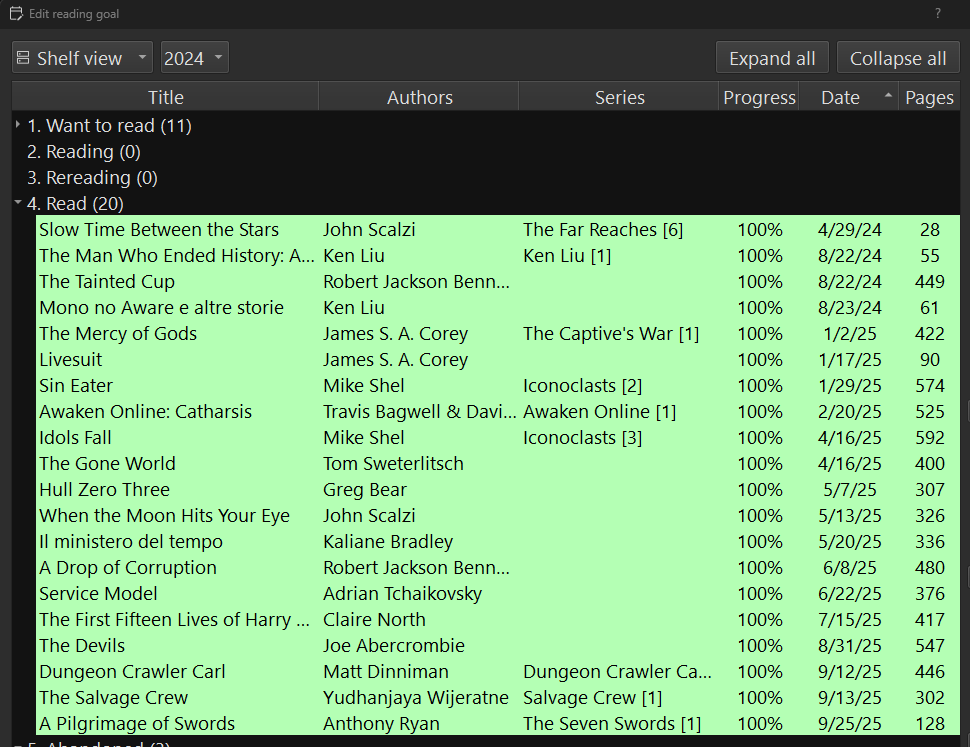

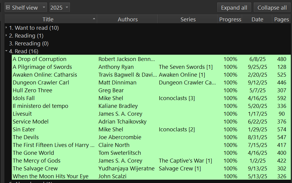

Edit Reading Goal not filtered by year
HI, I'm seeing the following issue. I' hope it's not in the previous 62 pages.
I have added several read books from year 2025 and 2024 and 2022.
If I select 2025 I see all of them
If I select 2024 I see both 2024 and 2025. Is this correct?
If I select 2022 I see only 2022 books.
Should I restart from scratch? I've tried to remove a book from 2025 and it disappeared in both lists (2025 and 2024) but when I added it again it appeared again in both.
I also see the Want to Read list of 2025 when I select 2024

Hi.
Can you please PM your plugin database (it's a JSON file; you can export it from the 'Edit reading goal' dialog)? I'll check if I can identifiy the problem. No one ever complaint about something like that before.
Also, please select the books in your goal and choose 'Mark selected books', then close it and take a screenshot of your calibre library main window (I hope the related columns are visible in the screenshot). This will give more info to investigate.

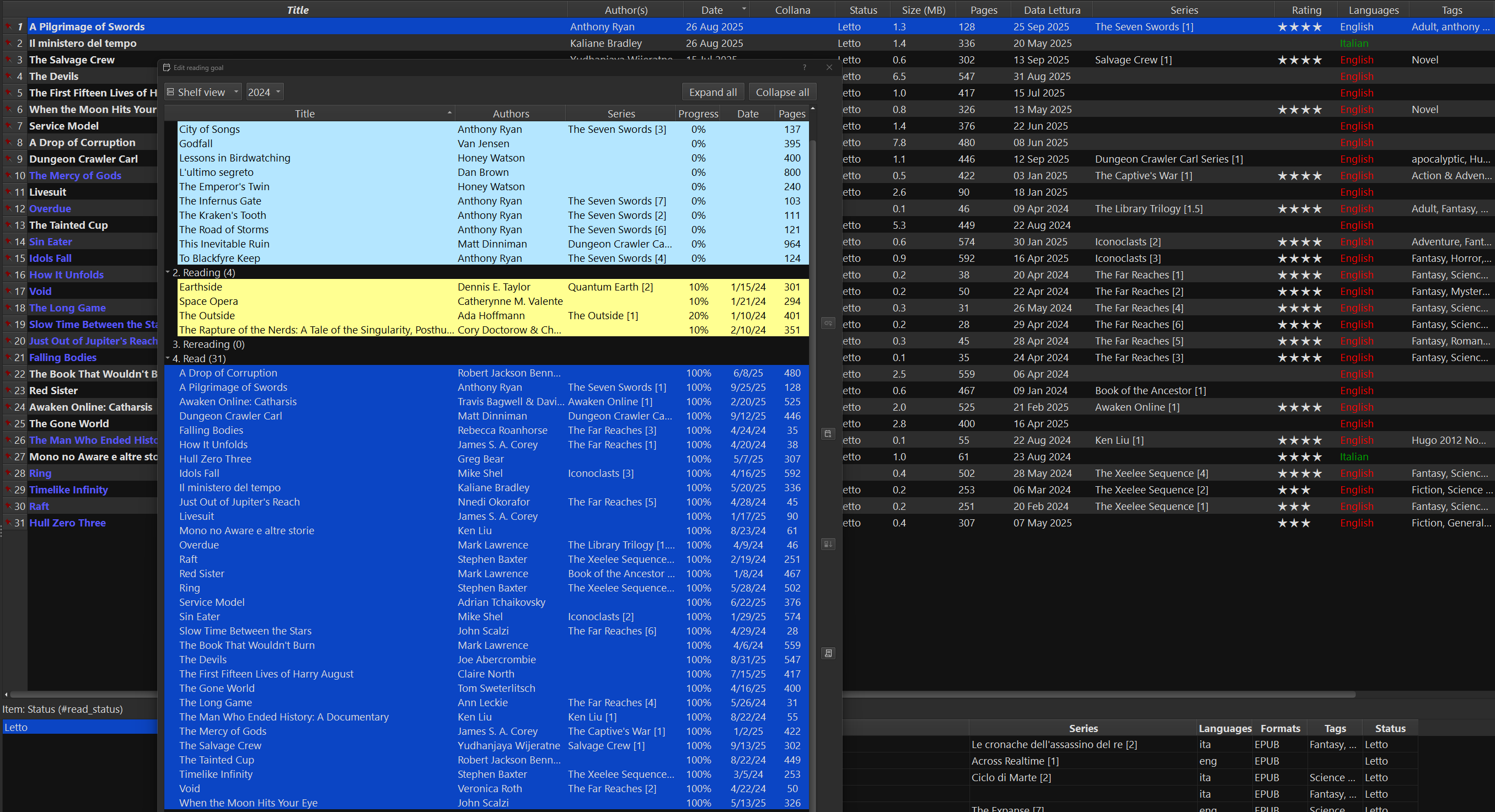

@tiago.eec
I sent you PM for the db. Here is the screen shot you requested
