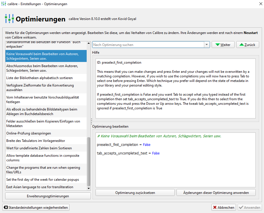

I found it. But there is no option I could select. When I type in "complet" as shown in your screenshot, I apply, close Calibre and open it again, nothing changed.

Now I understand, how it works. But unfortunaltely no combination of true/false solves my problem. Of course I closed and reopened Calibre after every change.
preselect_first_completion = False
tab_accepts_uncompleted_text = False
-> no success
preselect_first_completion = True
-> no success
tab_accepts_uncompleted_text = True
-> no success
-> no success
Heikili is offline   Reply With Quote

What about "completion_mode" - its default appears to be 'prefix', try changing it to 'contains'.
Thank you so, so much!
That was the solution. Your help saved me a lot of time and especially nerves
