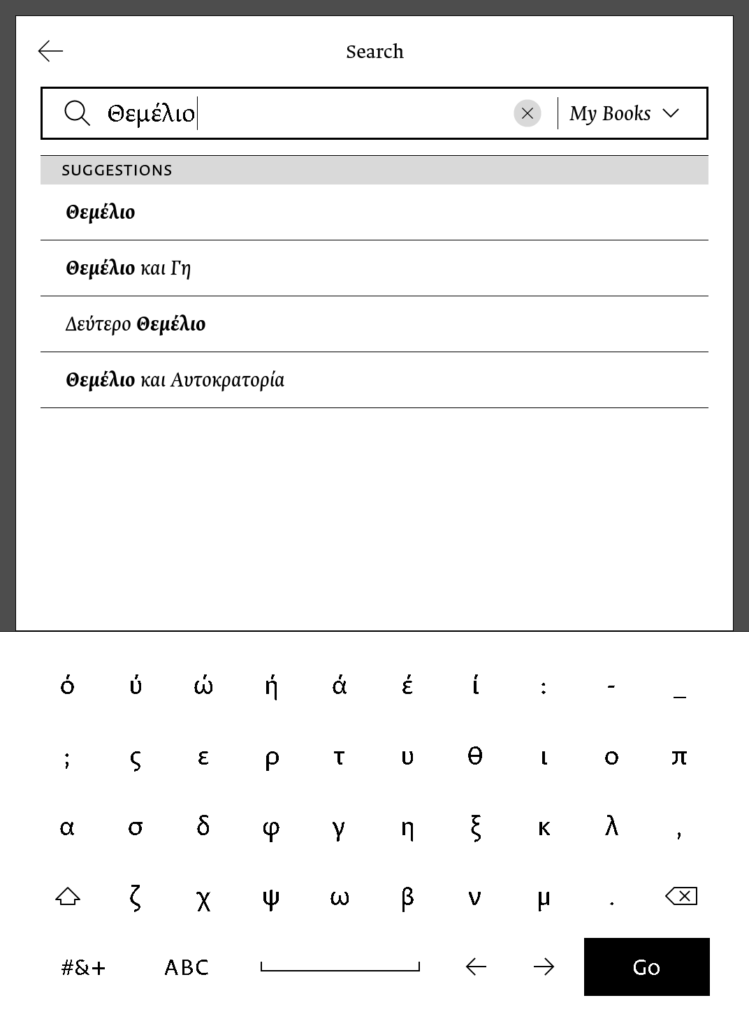

I have a Kobo Clara BW with firmware 4.42.23296 (May 2025)
If it is ok with the mods I want to share my KoboRoot.tgz for Greek fonts in names, titles, dictionary etc. and my kobopatch for greek keyboard, because the old one is not "complete" now, with no pop up for the extra letters.
kobo-ui-greek-fonts-support
Greek keyboard for kobopatch:
 # Replace layout sign Greek
  - FindBaseAddressString: "ÉÀÇ"
  - ReplaceString: {Offset: 0, Find: "ÉÀÇ", Replace: "ελ"}
  # Change keyboard layout
  - FindBaseAddressString: "ý\0\0ÿ\0\0š\0\0ž\0\0"
  # Top row, left to right (10 keys):
  - ReplaceString: {Offset: 0x00, Find: "ý\0", Replace: "ό"}
  - ReplaceString: {Offset: 0x04, Find: "ÿ\0", Replace: "ύ"}
  - ReplaceString: {Offset: 0x08, Find: "š\0", Replace: "ώ"}
  - ReplaceString: {Offset: 0x0C, Find: "ž\0", Replace: "ή"}
  - ReplaceString: {Offset: 0x10, Find: "æ\0", Replace: "ά"}
  - ReplaceString: {Offset: 0x14, Find: "œ\0", Replace: "έ"}
  - ReplaceString: {Offset: 0x18, Find: "þ\0", Replace: "ί"}
  - ReplaceString: {Offset: -56, Find:  "ß\0", Replace: ":"}
  - ReplaceString: {Offset: 0x1C, Find: "ij\0", Replace: "-"}
  - ReplaceString: {Offset: 0x20, Find: "ŀ\0", Replace: "_"}
  # Second row, left to right (10 keys):
  - ReplaceString: {Offset: 0x28, Find: "à\0", Replace: ";"}
  - ReplaceString: {Offset: 0x2C, Find: "á\0", Replace: "ς"}
  - ReplaceString: {Offset: 0x30, Find: "â\0", Replace: "ε"}
  - ReplaceString: {Offset: 0x34, Find: "ä\0", Replace: "ρ"}
  - ReplaceString: {Offset: 0x38, Find: "ã\0", Replace: "τ"}
  - ReplaceString: {Offset: 0x3C, Find: "å\0", Replace: "υ"}
  - ReplaceString: {Offset: 0x40, Find: "è\0", Replace: "θ"}
  - ReplaceString: {Offset: 0x44, Find: "é\0", Replace: "ι"}
  - ReplaceString: {Offset: 0x48, Find: "ê\0", Replace: "ο"}
  - ReplaceString: {Offset: 0x4C, Find: "ë\0", Replace: "π"}
  # Third row, left to right (10 keys):
  - ReplaceString: {Offset: 0x50, Find: "ò\0", Replace: "α"}
  - ReplaceString: {Offset: 0x54, Find: "ó\0", Replace: "σ"}
  - ReplaceString: {Offset: 0x58, Find: "ô\0", Replace: "δ"}
  - ReplaceString: {Offset: 0x5C, Find: "ö\0", Replace: "φ"}
  - ReplaceString: {Offset: 0x60, Find: "õ\0", Replace: "γ"}
  - ReplaceString: {Offset: 0x64, Find: "ø\0", Replace: "η"}
  - ReplaceString: {Offset: 0x68, Find: "ì\0", Replace: "ξ"}
  - ReplaceString: {Offset: 0x6C, Find: "í\0", Replace: "κ"}
  - ReplaceString: {Offset: 0x70, Find: "î\0", Replace: "λ"}
  - ReplaceString: {Offset: 0x74, Find: "ï\0", Replace: ","}
  # Fourth row, left to right (8 keys):
  - ReplaceString: {Offset: 0x78, Find: "ù\0", Replace: "ζ"}
  - ReplaceString: {Offset: 0x7C, Find: "ú\0", Replace: "χ"}
  - ReplaceString: {Offset: 0x80, Find: "û\0", Replace: "ψ"}
  - ReplaceString: {Offset: 0x84, Find: "ü\0", Replace: "ω"}
  - ReplaceString: {Offset: 0x88, Find: "ñ\0", Replace: "β"}
  - ReplaceString: {Offset: 0x8C, Find: "ç\0", Replace: "ν"}
  - ReplaceString: {Offset: 0x90, Find: "đ\0", Replace: "μ"}
  - ReplaceString: {Offset: 0x94, Find: "ł\0", Replace: "."}
ID:	218172   Click image for larger version
