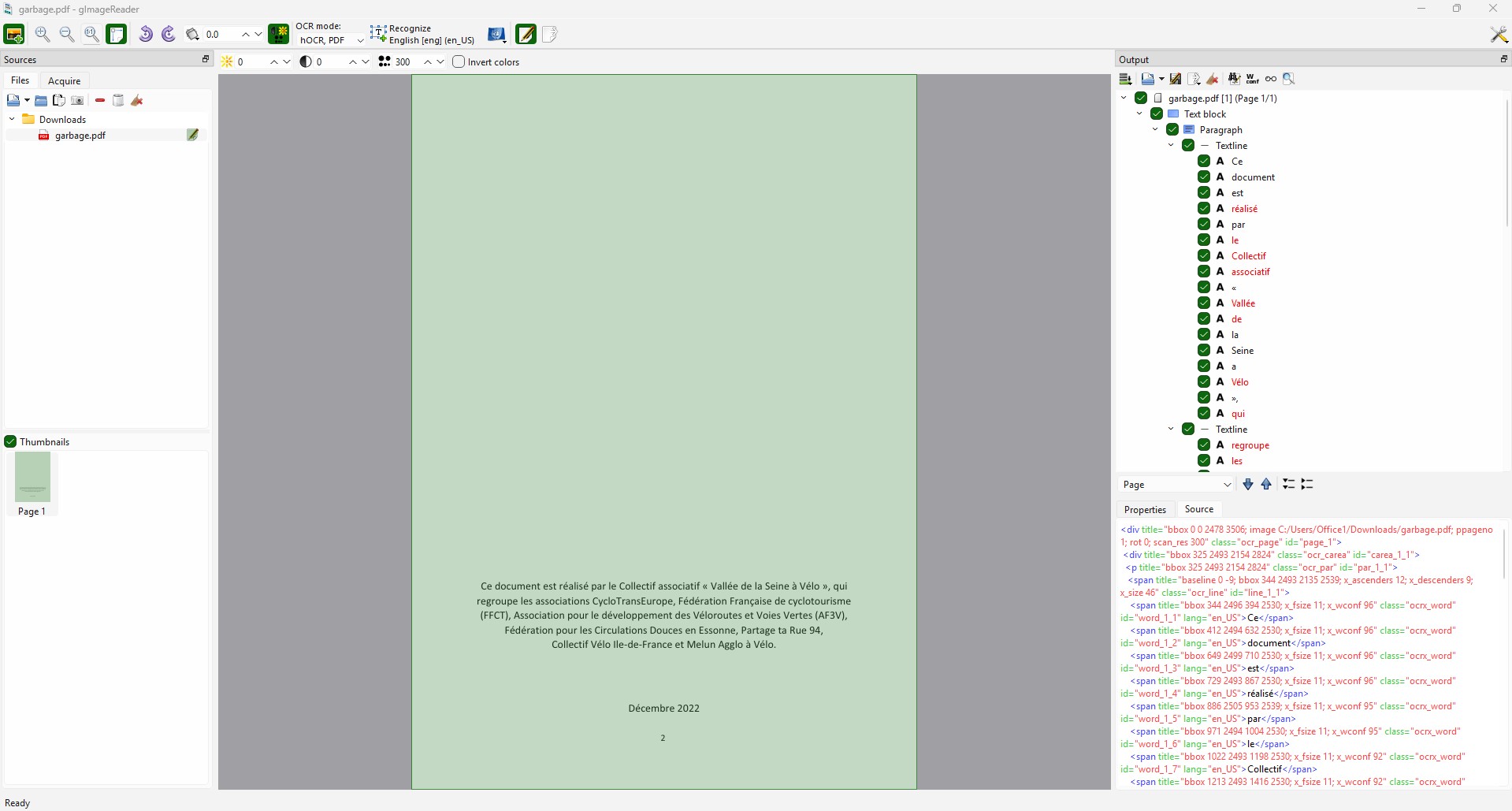

Out of curiosity I ran it through gimagereader and it found and exported the text correctly...

Thanks for posting an example PDF. Do you have any software that correctly copies and pastes the text from your sample (garbage.pdf)? I tried:
1. Loading the PDF directly into MS Word
2. Extracting the text w/k2pdfopt
3. Copying and pasting from SumatraPDF v3.5.2
4. Copying and pasting from Adobe Reader
5. Copying and pasting from Abby FineReader v16
All of them showed the same thing--basically repeated UTF-8 values of 0xEF 0xBF 0xBD.
I think the PDF itself is likely encoded incorrectly.
-Will
PS. gImageReader is a Tesseract OCR front-end. I don't believe it is extracting the text layer from the PDF. I think it's doing OCR on the sample to get the text.
