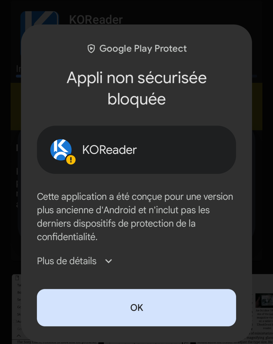

Recent Android compatibility issue
Hi,
I see the latest Koreader version is available on F-Droid.
However, it seems it is made for very old android versions, as my Pixel phone complains about security risk when trying to install.
Is it possible to distribute a version made for recent Android versions?
Thanks

Compatible with, not made for. There are also features that require at least Android 11. I don't think there's anything that requires a higher version otoh.
Are you sure it's not merely complaining because it's not from the Play store? You just have to let it scan it.

No problem with other applications from F-Droid.
After downloading KOReader from F-Droid, when starting the installation, it is complaining that the application was made for an old android version that include no confidentiality security.

Just ignore it. That's meaningless planned obsolescence gibberish from Google. It has nothing to do with privacy.
