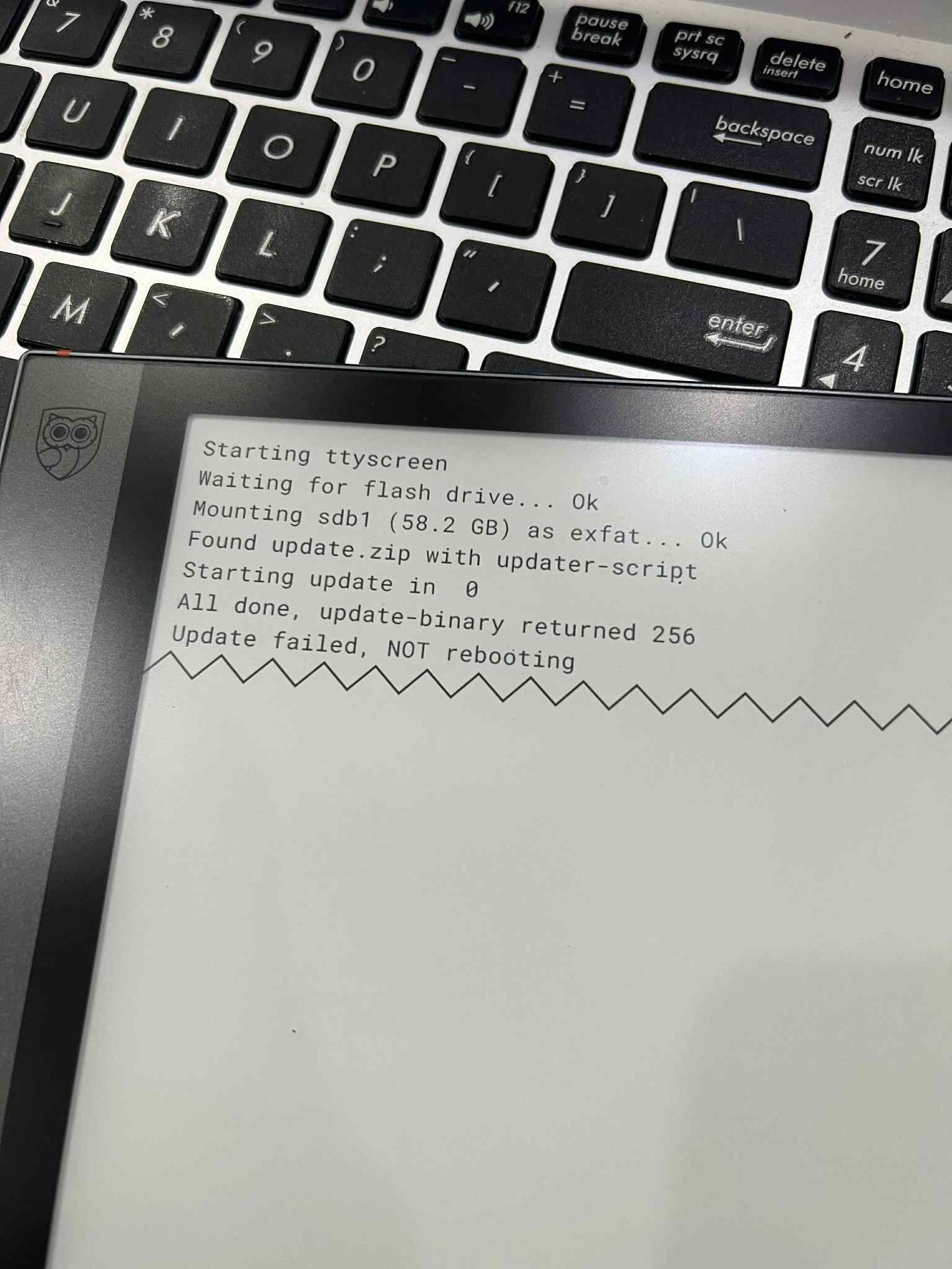

Sr for the late update. I used the same update.upx file as the link you provide. I downloaded it again, check md5 sum, no problem. Flashed it again, the same result. I think there is no problem with the update.zip file I use

Hi. I replace the original updater script with your new script. Still the same error, and no autolog file generated.
Here my step by step. Could you have a look if I've done something wrong?
adb reboot edl
edl /lpoke3.bin
edl /w /precovery noteair-rec.img
edl /w /pmisc misc.img
edl /z
The misc file is from poke3 thread? Can it be used on my note air?
After that the device boot right into blank screen
adb shell
#id
#start autoupdate
Then it shows the waiting screen. But it show error when flash
Boox4ev is offline   Reply With Quote

I don't see any error.
