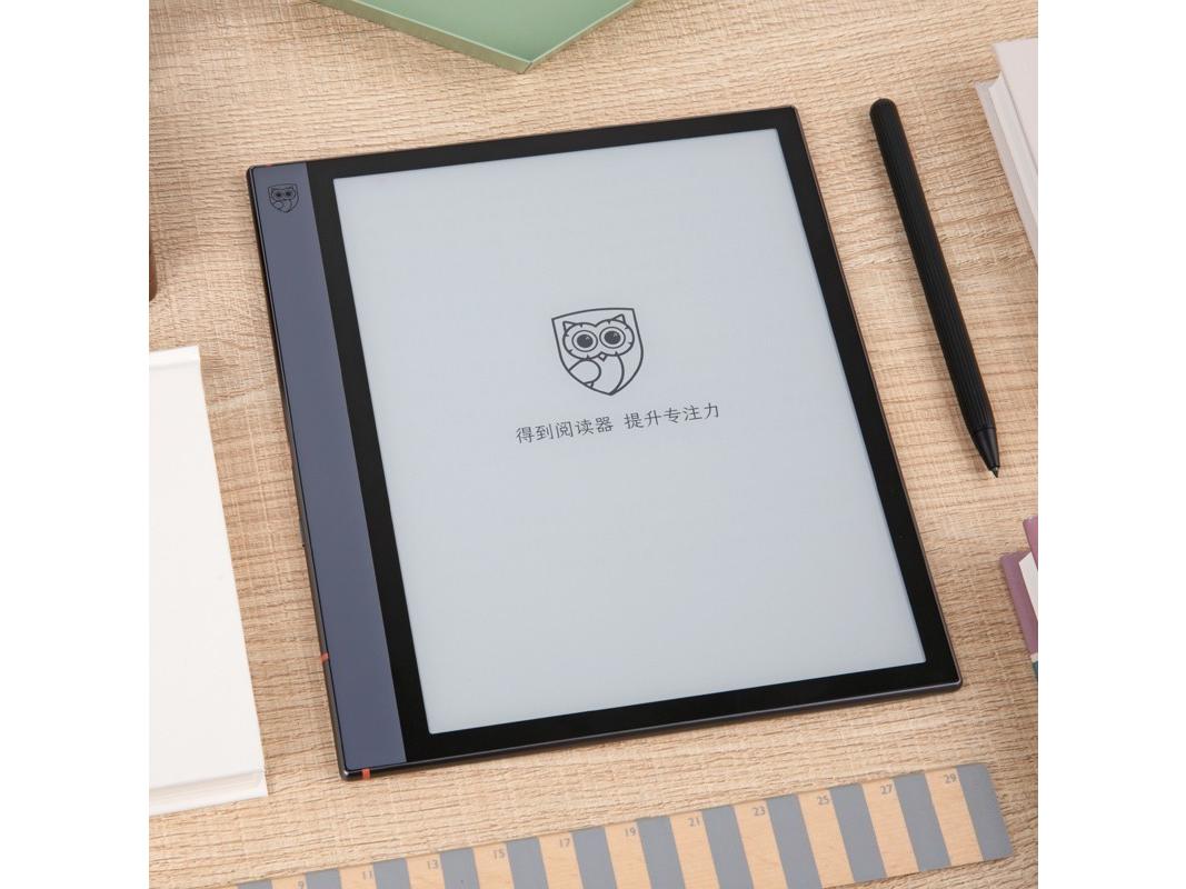

Hi guys. I've got a used Iget Flow Pro Max, which is an oem model of Note Air that Boox make for Iget (a reading app in china)
It's is running an modified android, not open as Boox so I want to flash it to Note Air firmware

Here is the Flow Max. Same with Note Air but with an Owl Logo
