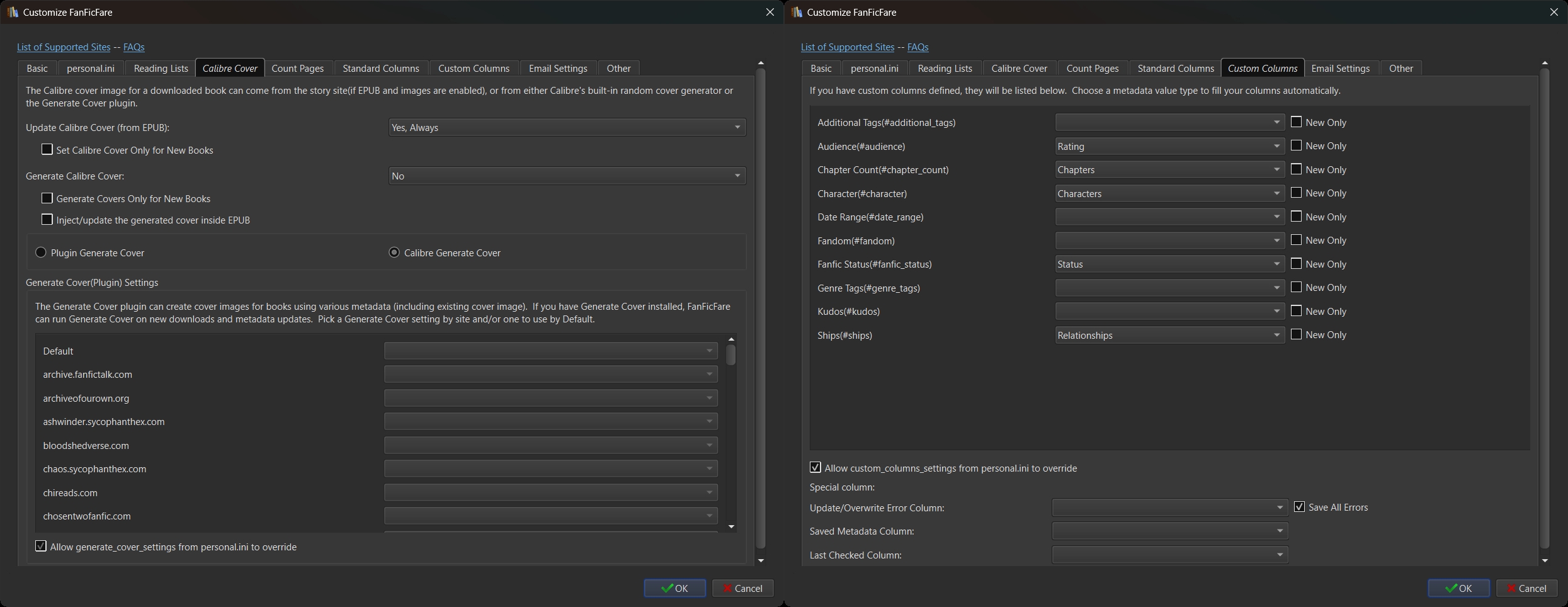

You can share your full personal.ini here, make sure you share the "safe" personal.ini. (Fanficfare settings > personal.ini tab > View "Safe" personal.ini)
Enclose it in spoiler and code tags:
Like this so it doesn't take up too much vertical space.
And a screenshot of your Fanficfare Custom Columns window. (Fanficfare settings > Custom Columns tab)

# FanFicFare Configuration File - Optimized for AO3 & Calibre Integration
# ================================================[defaults]
# BASIC SETTINGS & FORMATTING
# HTML processing options
replace_xbr_with_hr:3
replace_hr:false
replace_br_with_p:false
slow_down_sleep_time:0.5
# Date formatting (http://docs.python.org/library/datet...ptime-behavior)
datePublished_format:%%B %%d, %%Y
dateUpdated_format:%%B %%d, %%Y
include_subject_tags:filtered_freeform_tags,freeformtags
include_in_genre:genre,forumtags,freeformtags,ao3categories
# include_subject_tags should have values if you want to put tags in Calibre.
#If you don't want to use the prefix_* tags you can remove those lines entirely
# and add the tags you want in include_subject_tags.
# CUSTOM FIELD DEFINITIONS
# Define all custom metadata fields we'll create from AO3 data
add_to_extra_valid_entries:,additional_characters,category_main,dateRange,icon_bookmarked,icon_subscribed,icons,prefix_category,prefix_rating,prefix_ships,prefix_status,prefix_wordcount,fanfic_rating,fanfic_status,filtered_freeform_tags
# Labels for custom fields (how they appear in Calibre)
additional_characters_label:Characters
category_label:Fandom
category_main_label:Fandom
dateRange_label:Date Range
filtered_freeform_tags_label:Genre Tags
ship_label: Ships
freeformtags_label:Freeform Tags
# Define what source data goes into each custom field
include_in_additional_characters: characters
include_in_category_main: category
include_in_dateRange: datePublished,dateUpdated
include_in_icons: icon_bookmarked,icon_subscribed
include_in_prefix_category: category
include_in_prefix_rating: rating
include_in_prefix_ships: ships
include_in_prefix_status: status
include_in_prefix_wordcount: numWords
include_in_filtered_freeform_tags: freeformtags
# Preserve order of items in lists (important for consistency)
keep_in_order_category:true
keep_in_order_characters:true
keep_in_order_ships:true
keep_in_order_additional_characters:true
keep_in_order_category_main:true
keep_in_order_dateRange:true
keep_in_order_icons:true
keep_in_order_prefix_category:true
keep_in_order_prefix_ships:true
keep_in_order_filtered_freeform_tags:true
# METADATA FILTERING & EXCLUSIONS
exclude_metadata_pre:
# Remove redundant fandom suffixes
 category=~(.*) - Fandom
# Filter out generic/useless character entries
 additional_characters==Other(s)
 additional_characters=~(Original|Various) Character\(?s?\)?
# Remove generic placeholder tags
 freeformtags,genre==Other Additional Tags to Be Added
 warnings==Creator Chose Not To Use Archive Warnings
 warnings==No Archive Warnings Apply
# Ship filtering - remove non-relationship entries
 ships,prefix_ships!~(.*)(\/| & )(.*)     # Must contain / or &
 ships,prefix_ships=~(.*) & (.*)          # Remove platonic relationships
 prefix_ships=~^(.*)\(?(implied|mentioned)\)?  # Remove implied/mentioned ships
# METADATA TRANSFORMATIONS & REPLACEMENTS
replace_metadata:
# Rating standardization
 rating=> Audiences=>
 rating=>Teen [Aa]nd Up=>Teen
# Relationship processing
 ships=>(.*)[/](.*) \(?[Ff]riendship(?: only)\)?=>\1 & \2
# Fandom cleaning
 category,prefix_category=>No Fandom=>Original Work
 category,prefix_category=> \(?(- All Media Types|- Fandom|Movies|Movie [0-9]+|Comics|TV|Video Games?)\)?$=>
# Character name cleaning
 additional_characters=> - Character=>
 additional_characters=> ?\((cameo|briefly|if you squint|sort of)\)=>
 additional_characters=> \([Cc]haracter\)=>
 additional_characters=>\(mentions of\) =>
# Ship name cleaning
 category,ships= - Fandom$=>
 ships=> - Relationship=>
 ships=>^(.* - Relationship)$=>
 ships=>^(Eventual (.*)/(.*))$=>
# Extract first item for prefixed tags (for Calibre tag system)

add_to_custom_columns_settings:
 additional_characters=>#character           # Characters column
 category_main=>#fandom                     # Fandom column
 rating=>#audience                          # Audience/Rating column
 ships=>#ship                               # Relationships column
 chapterslashtotal=>#chapter_count          # Chapter count column
 dateRange=>#date_range                     # Date range column
 freeformtags=>#additional_tags             # All original tags column
 filtered_freeform_tags=>#genre_tags        # Filtered genre tags column
 bookmarked=>#work_bookmarked              # Bookmark status column
 subscribed=>#work_subscribed              # Subscription status column
 fanfic_rating=>#fanfic_rating             # Original rating column
 fanfic_status=>#fanfic_status             # Work status column
 kudos=>#kudos				   # Kudos from AO3
