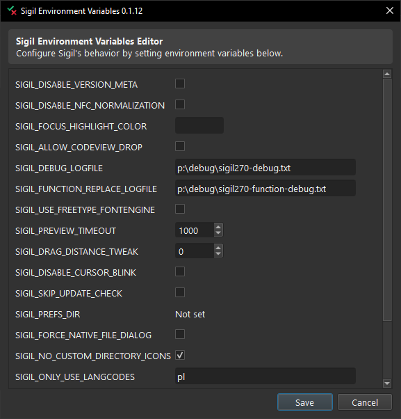

[Plugin] EnvVarEditor - GUI editor for Sigil's environment variables
Updated: November 3, 2025
Current Version: 0.1.12
Status: Stable
Plugin type: edit
Plugin icon:
How it works:
This plugin provides a simple GUI editor for Sigil's env-vars.txt file, which is a new feature introduced in Sigil 2.6.2.
Normally, editing this file requires manual text editing, which can be error-prone. With EnvVarEditor, you can easily view, add, remove, and update supported environment variables directly from within Sigil.
The plugin:
  • Lists all known Sigil environment variables with proper input widgets (checkboxes, text fields, spinboxes).
  • Supports validation of values (e.g., numeric ranges, valid hex colors).
  • Allows removing variables entirely from env-vars.txt if they are not needed.
  • Preserves any custom or unknown entries that already exist in the file.
  • Prints a short summary of what was written back to the file after saving.

Screenshot
