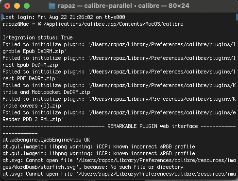

I mean running it like in the first attached image.
Originally Posted by thiago.eec View Post
P.S.: I just noticed that, for some reason, I forgot to publish the last release (version 0.2.0). Please remove Check Books complely and install the new version from the first post (or via calibre, in an hour or so).
Thanks, but I'm still having the same issues. See attached images, one from running from Terminal, one without. Note that the issues are the same for all EPUBs.

Following up on my issue. I've managed to clean up my Calibre installation and capture a clean debug log of the "Check Books" plugin failing.
The Key Finding: The plugin seems to fail silently. When I run the check, the external ACE tool appears to crash without returning any error message to the Calibre debug log.
My System:
macOS 15.7 on Apple Silicon
Calibre 8.9 (running on Python 3.11.12)
Node.js is installed at /usr/local/bin/node
What I've Confirmed:
The problem occurs on all EPUBs, including the DRM-free Calibre "Quick Start Guide."
Calibre has Full Disk Access.
I have a clean plugin environment after removing several old, incompatible Python 2 plugins.
I am launching Calibre from the terminal (calibre-debug -g) to ensure the correct PATH is used.
Please see the complete, clean debug log below. It captures Calibre starting up, me running the check (which produces the "Invalid EPUB" error in the GUI), and then me shutting Calibre down. As you can see, after the startup sequence, no specific error from your plugin is logged to the console.
