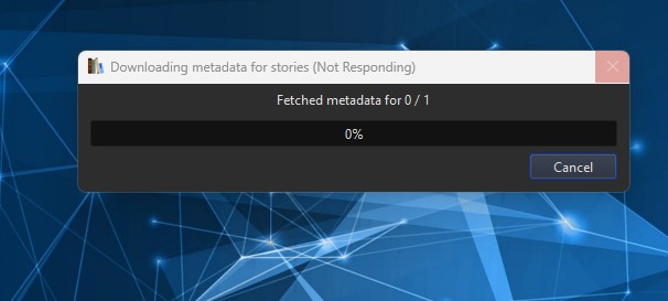

Basically, yes.
Thank you, and I appreciate the response. Is there anything I can do to speed it up or perhaps configure that would eliminate any unnecessary processes?
I pretty much just read from Novelfull only.
I saw your Github closed post from about 2.5 weeks ago that you referenced an old closed post from 3 years ago about Novelfull/flaresolverr. Ironically, I've never run it until now, never had issues with FFF and Novelfull until about 2.5 weeks ago... been using both for over 3+ years...
It all started right after 8.8 Calibre/4.48 FFF came out (because I updated my books on 07/29 and they worked, but updated the software the following weekend)... pure coincidence probably, but very odd timing all the same.
Really appreciate the work btw, it's a great feature that works very well.
With running flaresolverr, is it possible to go after other sites like Novelbin or FreeWebNovel?
We've been seeing these issues for 4+ years on various sites. You were lucky to not have issues until now.
No.
