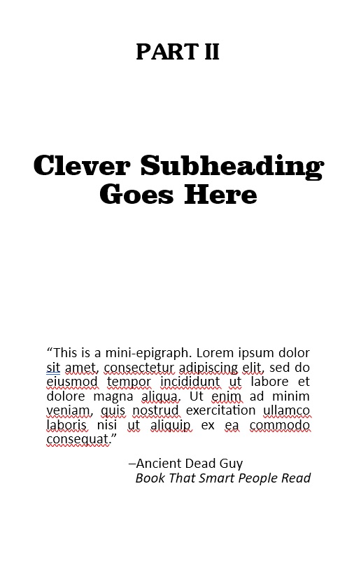

Formatting chapter/title pages with offset blocks of text
I know there are some strong feelings out there about trying to simulate paperbook layouts in the context of reflowable, re-sizeable ebooks. For example, I've seen repeated calls against top margins on chapter headings or simulating text that starts "half-way" down the page, presumably because screen sizes and text sizes could potentially result in blank pages, unusual gaps between text, etc.
However...
I'm wondering how the pros here handle content that is seemingly necessary to format with various top & bottom margins and variable font sizes (see attached image). Do you assume a certain font-size (i.e. assume 1em is the size of some referent physical book, or assume a certain number of lines of text per ereader page) and screen size and hope for the best? What are these assumptions?

Sorry, all. Wasn't very clear in my question...
I know that in a reflowable context, I can't make fixed formatting (except as an image). And I also know that the number of lines per screen changes depending on the size of the reader and the size of the screen.
What I was wondering is, given these facts, how do you prefer formatting source text that was materially (but not critically) dependent on SOME degree of positional formatting (as in the above-attached example).
My question regarding assuming default font sizes and screen sizes, wasn't meant to suggest that there IS a default font size or screen size, merely to wonder if (like phsyical books) ebook publishers/producers do (or should) assume an "ideal" font-size and layout. Obviously, physical publishers didn't/dont' have to worry about "screen" size as a variable, but they do have to consider user reading preferences (and accessibility) in setting their font sizes, right? And then, having done so, they select a font size, knowing it is not a one-size fits all solution: some people may need to wear glasses to comfortably read their books, while others may have to buy an entirely different version that is "large-print".
Similarly, an ebook producer might design a book with an idealized font-size/screen-size in mind, or at least a range. I mean, whether you realize it or not, you already are doing it. For example, if you have a reader who sets their font size to 500%, that's potentially going to change the readability of a given book, no matter how conservatively/simply you format it. At 500%, certain words may not fit on a screen, much less fit on it while including paragraph indents, thus making distinguishing paragraphs impossible for that reader. But I also suspect that most ebook producers are not assuming that a reader will set their font size to 500% on a 3-inch-wide screen using software that doesn't incorporate hyphenation. They are idealizing (even if its a range rather than a singular value) the reader's settings.
So, to be more explicit: given the example in the first post, what kinds of margins and font sizes would you assume for the three elements in order to maximize readability? Would you, for example, maintain some kind of left/right margins on the epigraphical text? Would you maintain a spacing difference between the main heading and subheading vs subheading and epigraphical text (not to mention font size and font family)? etc., etc., etc.

I usually just consider the spacing relative to other elements, rather than spacing within a fixed page. So, in your example, how far the heading, subheading, and quotation should be from one another, not where they land on the page. I tend to crowd the top a little more than I would for print, and I might force a break if I really want to avoid weirdness.
So in your example, I'd probably drastically reduce the space above/below the subheading, and if I was feeling really fussy, I might also force a break before the quote.

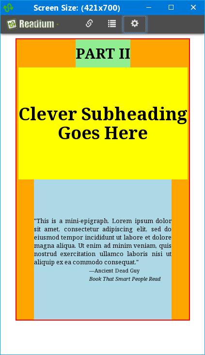

I format for both, epub2 and epub3, but the epub3 format is richer in possibilities. Under epub3 you can achieve things that are impossible in epub2 and you can make it even easier. For example you can try to "duplicate" the layout of the image you uploaded by means of a flex-box. A freehand code (it could be much improved, it's just a hastily written draft) could be the following (the borders and colors are so you can see the blocks that make up the flex-box design; in case the user increases the font size, the text should grow only within the space of the assigned color):
1) XHTML:
  <div class="pageContainer">
    <div class="partTitle">
      <h2>PART II</h2>
    </div>
    <div class="subheadingContainer">
      <h1 class="subheading">Clever Subheading<br/>Goes Here</h1>
    </div>
    <div class="epigraphContainer">
      <p class="epigraphText">"This is a mini-epigraph. Lorem ipsum dolor sit amet, consectetur adipiscing elit, sed do eiusmod tempor incididunt ut labore et dolore magna aliqua. Ut enim ad minim veniam, quis nostrud exercitation ullamco laboris nisi ut aliquip ex ea commodo consequat."<br/><span class="epigraphAuthor">—Ancient Dead Guy</span> <span class="epigraphBook">Book That Smart People Read</span></p>
    </div>
  </div>
2) CSS:
body {
    font-family: serif;
    height: 90vh;
    width: 100%;
    box-sizing: border-box;
    margin: 0;
    padding: 0;
    border: 2px solid red;
.pageContainer {
    display: flex;
    flex-direction: column;
    justify-content: flex-start;
    align-items: center;
    width: 100%;
    height: 100%;
    background: orange;
.partTitle {
    font-size: 1.4em;
    font-weight: bold;
    text-align: center;
    height: 10%;
    display: flex;
    justify-content: center;
    background: lightgreen;
.subheadingContainer {
    height: 40%;
    display: flex;
    background: yellow;
.subheading {
    font-family: serif;
    font-size: 2.5em;
    font-weight: bold;
    text-align: center;
    line-height: 1.1;
.epigraphContainer {
    height: 50%;
    width: 80%;
    align-self: center;
    display: flex;
    align-items: flex-start;
    background: lightblue;
.epigraphText {
    text-align: justify;
    font-size: 0.9em;
    text-align-last: left;
.epigraphAuthor, .epigraphBook {
    display: inline-block;
    width: 60%;
    margin-left: 40%;
    font-size: 0.9em;
.epigraphBook {
    font-style: italic;
3) THE OUTPUT:
Note that there is no single margin set (except for a margin:0 for body) and that all spacing between blocks is handled by the flex-box based on the assigned heights. There's no need for any calculations; the .css code handles everything.

Originally Posted by ElMiko View Post
...the epub file might require having functionally the whole book duplicated inside so that it could toggle your at-rule?
Yes, that is; mainly about how to handle images.
<div class="epub3Code epub2Code">
   All the code for epub3 AND epub2 here...
</div>
No, no of that way. But you could have:
<div class="myStyle">
    Your elements/blocks to be formated here
</div>
and in your .css stylesheet:
.myStyle { /* here the style for epub2 */
   display: block;
   margin-top: 3em;
   etc...
@supports(display: flex) { /* if this is true, then we are under epub3 */
   .myStyle { /* Here the style to be applied on epub3 */
       display: flex;
       margin-top: revert; /* or margin-top: 0; you'll see what is better, depends on each case */
       etc...
So, in this case, the XHTML code is the same for both, epub2 and epub3, BUT the .css is different.
