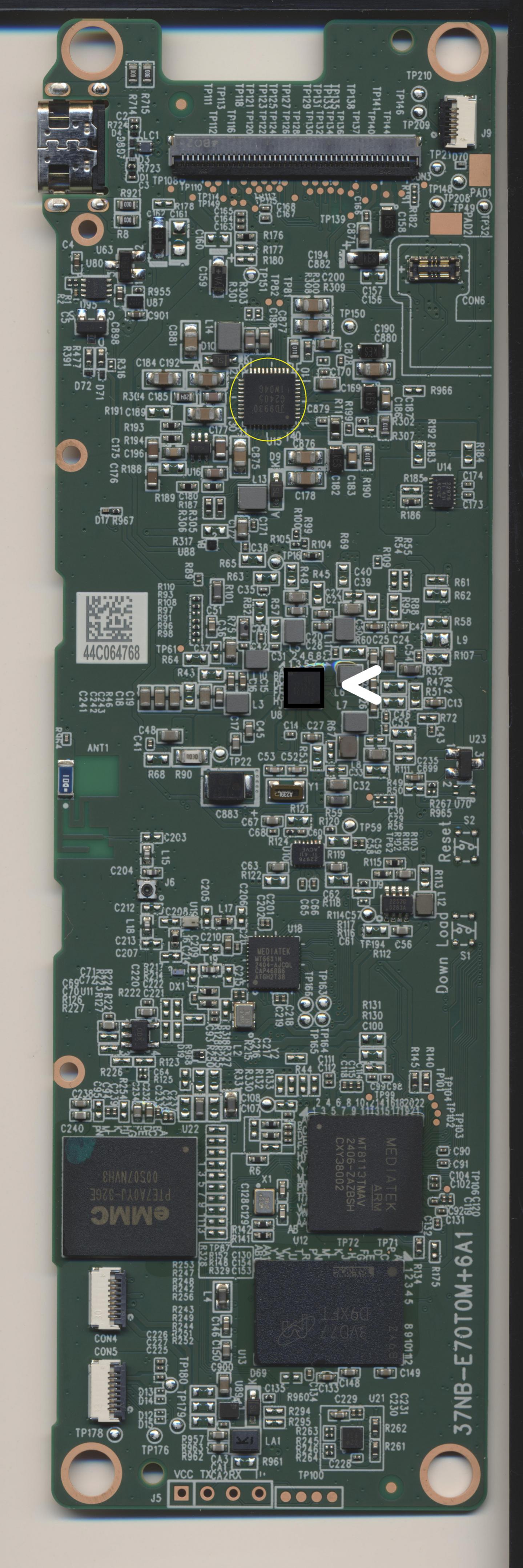

You may want to look at iFixIt's Kobo Libra Colour Repair for parts, costs and guides. From your description, it sounds as if it is a motherboard issue since the area you are describing is where the power supply (JD9930) chip lives.
This is the area thats getting hot marked with the arrow, i guess its more near the buttons but that spot you mentioned does get abit warm but the heat is generated at the spot i mentioned and when i mean heat its a "burn to the touch" as if you touched a hot metal rod.

I'm not certain as to what purpose that chip serves but on my KLC that area does not get warm when charging.
Im unsure why does get really hot on that chip but is it safe to say i need to replace the systemboard only? and will the battery be affected too incase that needs replacement.
Impossible to know without additional information.
