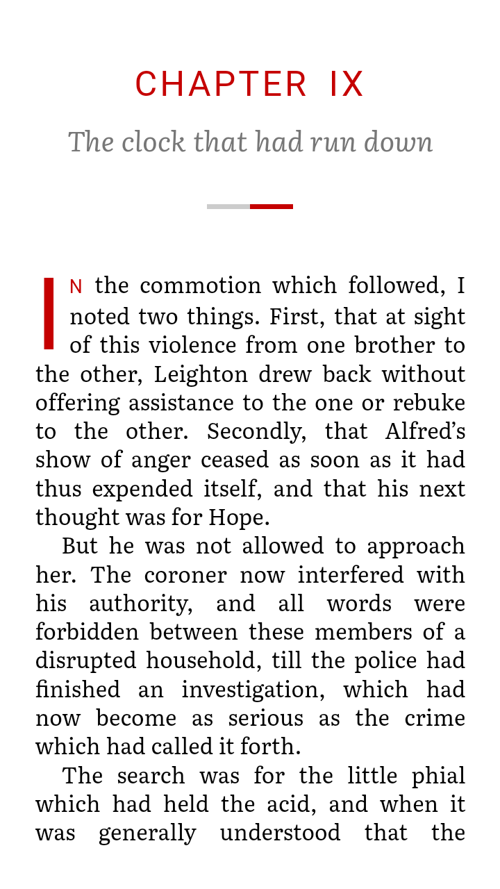

Well, just because I do "something" doesn't mean that that "something" is right. At most, I can only say that "something" is right, but only for me.
But I'm going to defend my position. And I'm going to do so based on what's happening with Google Play Books and PocketBook ereaders (which I've seen from your comments that you use).
The following is a screenshot of an epub opened with GPB styled with my .css styles:

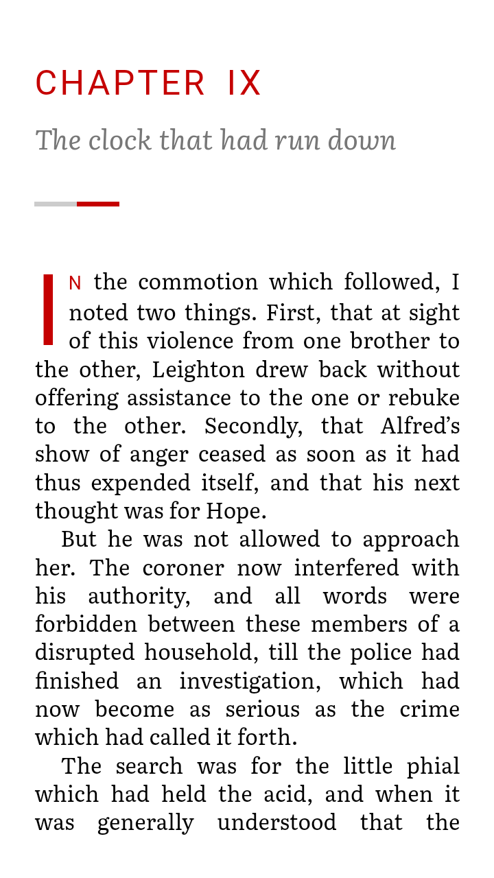

What happens when I select from the GPB menu text-align to left? The following:
As you can see, GPB aligns to the left ALL THE TEXT, not only the text in <p> tags but also text in <h*> tags. And what happens if I select justified text? The following:
The text in <h*> tags remains aligned to the left. Now imagine the disaster that would occur if proper alignment weren't included, with paragraphs that should be aligned to the right or center? If you let users set the alignment, they won't get the best reading experience. By adding your own style, you give them a point of comparison between what they can get on their own and what the book can provide by default.

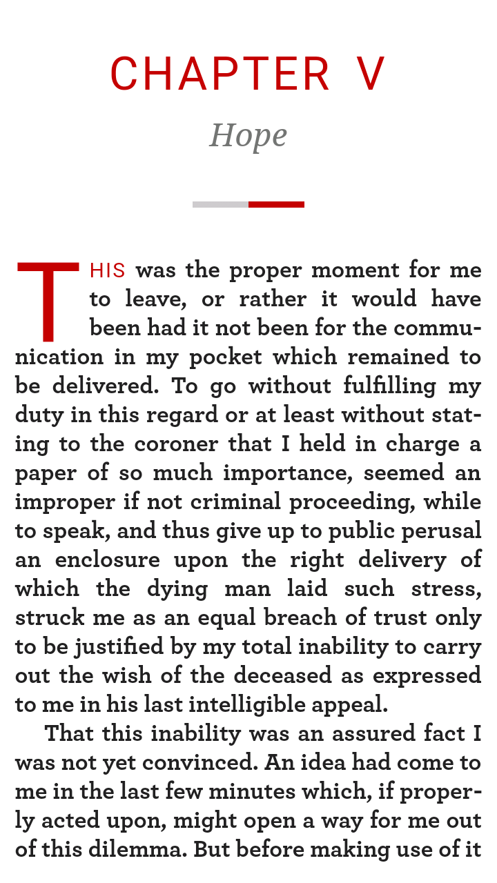

And the same thing happens in PB. The following screenshot is from another chapter in the same book, with the default styles:
Now, PB is smarter than GPB and doesn't allow you to change the alignment unless the user disables the styles built into the .css file. What happens if you disable those styles and set the alignment to left? Well, this is it:
Compare the reading experience with built-in styles and what users can achieve by disabling them.
