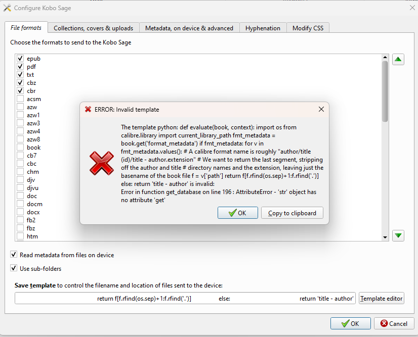

Istsielieniie dukhovnykh boliez - Zhan-Klod Larshie.epub Now, the file (truncated same as before) is placed into the root directory of the device. |

You are correct. Of course, the intent was to produce the identical file name on the device equal to one in the Calibre library - which your code did. Is there a way to modify the code to place the file in the {Author} folder? This would really solve the issue for me .
#40 |
![]() ![]() ![]() ![]() ![]() ![]() ![]() ![]() ![]() ![]() ![]() Posts: 73
Karma: 11226
Join Date: Mar 2022
Device: Kobo Sage, Libra 2, Aura H2O
Also, the above code produces double extension such as
Istsielieniie dukhovnykh boliez - Zhan-Klod Larshie.epub.epub |

@chaley Thank you! I kept struggling with the double extension issue. While adding the author directory to the destination was not difficult, for whatever reason I had to try several things to address the double extension thing. In the end the only solution which worked was to remove the extension from the filename before returning it, letting Calibre add it back during the transfer process. Here is the code which finally worked for me:
Python:
def evaluate(book, context):
import os
fmt_metadata = book.get('format_metadata')
# Get main author safely, fallback 'Unknown Author', and sanitize for filesystem
author = book.get('authors', ['Unknown Author'])[0].replace('/', '_').replace('\\', '_')
if fmt_metadata:
for v in fmt_metadata.values():
# Extract only the filename with extension
f = v['path']
filename = os.path.basename(f)
# **FIX**: Remove the extension since Calibre will add it automatically
filename_without_ext = os.path.splitext(filename)[0]
# Compose path as: {Author}/{filename (WITHOUT extension)}
return '/'.join([author, filename_without_ext])
else:
# For fallback, also remove extension since Calibre will add it
return '/'.join([author, 'title - author'])
