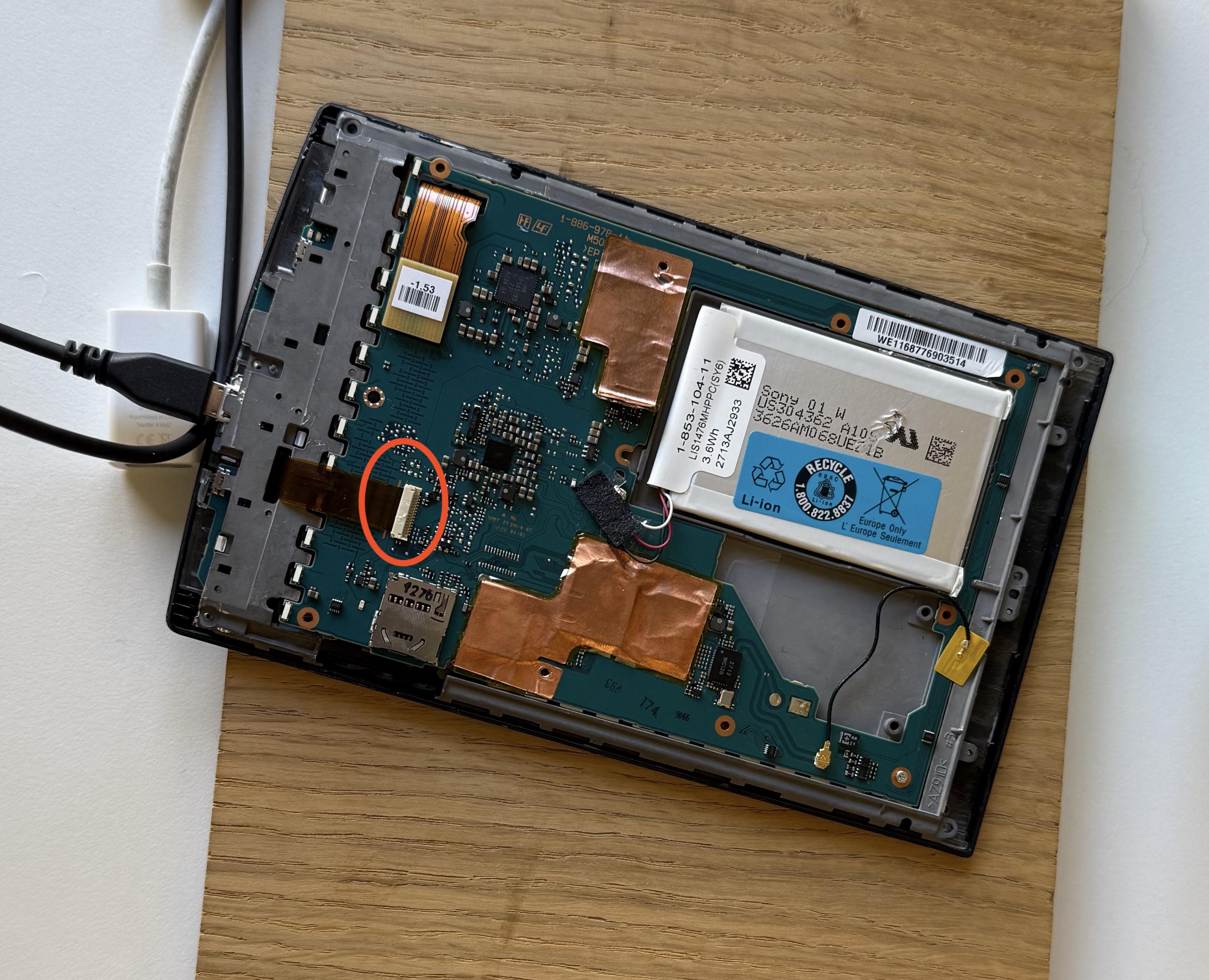

I've had/am having this issue as well.
It appears for me that a connector seems a little loose inside.
If I press rather firm on the connector, the charging and PC connection works for me.
But now I have to figure out how to actually fix it.

Ooh. I didn't try plugging it in and doing that with my T1. I should check it that way too. Maybe some electrical tape?
Edit: No luck.
