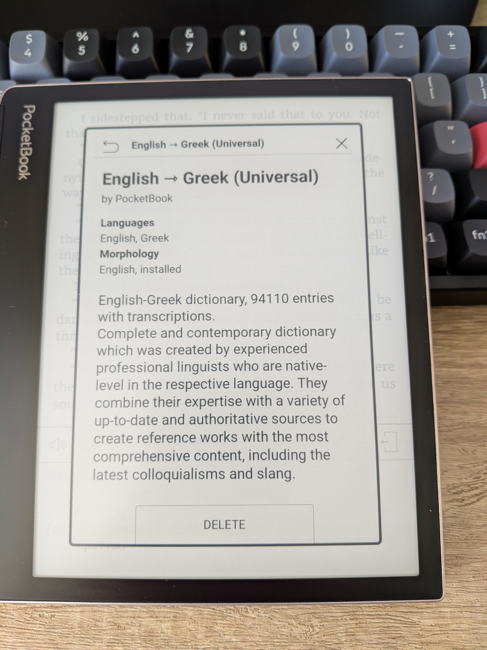

Originally Posted by rkomar View Post
Official dictionaries are stored in a separate filesystem and mounted under "/mnt/secure". The default user account does not have access to that filesystem. You would need to be root or user "sreader" to be able to read and backup files in there.
Oh, I don't have the knowledge to do all these
I believe that PocketBook license the dictionaries installed there from others, and it is likely to be part of the agreement that they do not allow the files to be copied and used elsewhere. So, they are hidden as much as possible.
The dictionary appeared out of the blue a few weeks ago. My country is not a big "market" and I am afraid that maybe it disappears with the same way. I don't want to use it somewhere else. I have it, I want it just for backup.
Thank you for your time

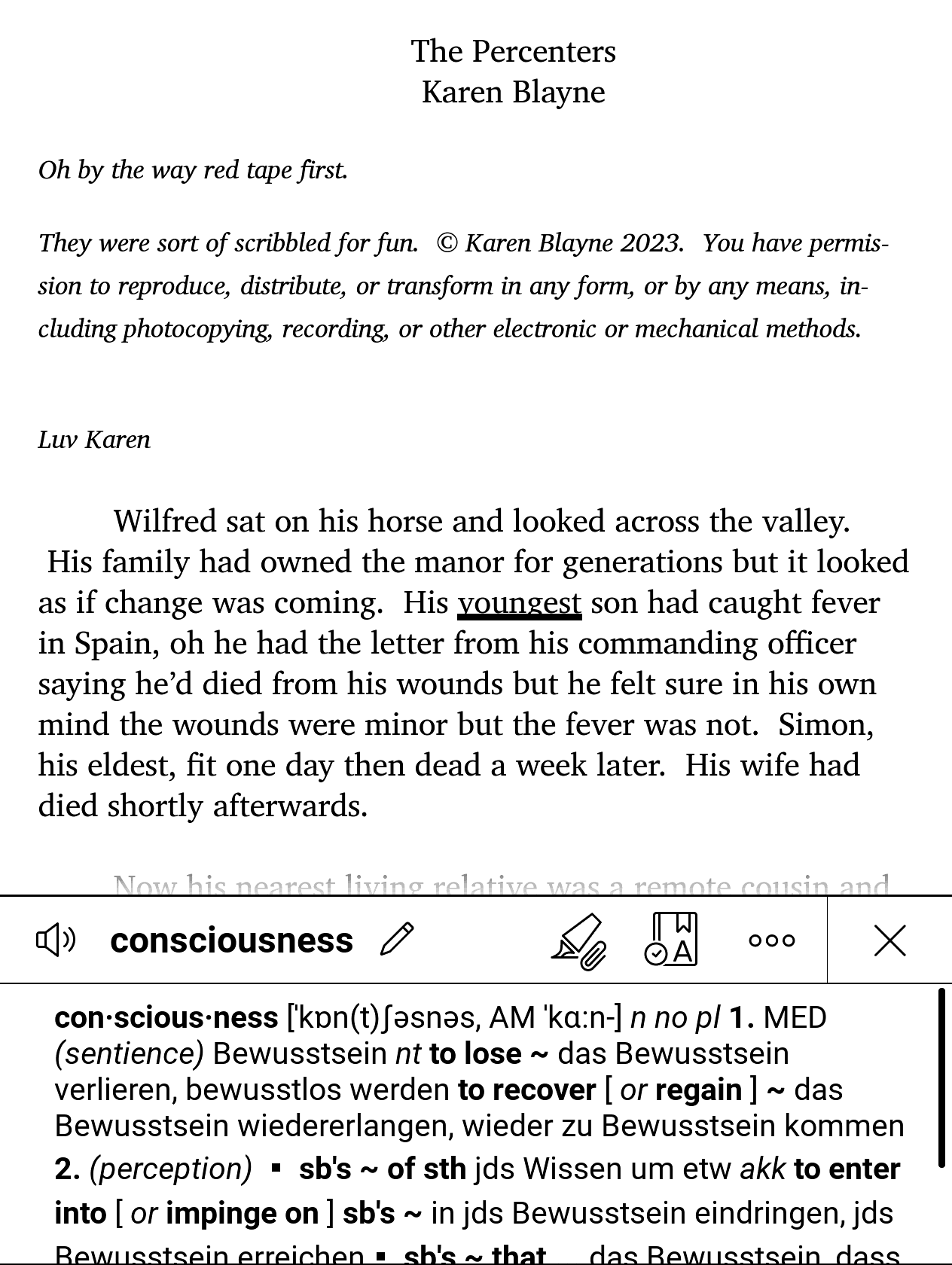

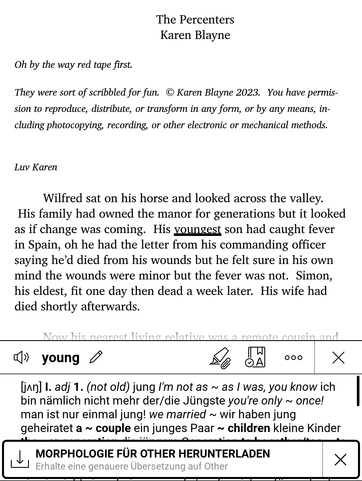

Originally Posted by Markismus View Post
Could you check whether the dic-file works?
For others (and my future self): Copied the .dic file to system/dictionaries on the PB700.
Here are some notes and screenshots:
  • It appears with its name under "OTHER" in the dictionaries list. Maybe it needs the supported language pair set.
  • When selecting it, the PB prompts "Do you want to download Morpholgy for OTHER?" (no .aff file, I’m supposing) I wonder what the naming conventions are, because I have both EN and DE morphologies already installed.
  • Display looks a bit "glued together", but it is readable and I guess OK for the native reader app, because of the little screen estate we get.
  • The info is empty. Maybe language and description can be set somewhere.
  • The speaker button (read ord with TTS) is active and changes when clicking, but no sound to be heard. (PB dictionaries usually play the word using TTS)
So I’d say it works. You could probably put both EN-DE and DE-EN up, for others to benefit, what do you think?
N.B.: The short story I’m currently reading didn’t have the word "consciousness", so I manually typed it in (although "youngest" is selected).
P.S.: Looks to me the PB uses the rather standard Linux myspell/hunspell dictionary format (.dic & .aff morphology files), could that be true?
EDIT: Disregard the P.S. Just found that they use a proprietary format, apparently holding the dict and the index in one .dic file. Plus, you’d need a Windows "coverter.exe" transforming .xdxf dictionaries into their format. Morphologies I’m not sure about. Oh well, KOReader is much better with dictionaries anyway…

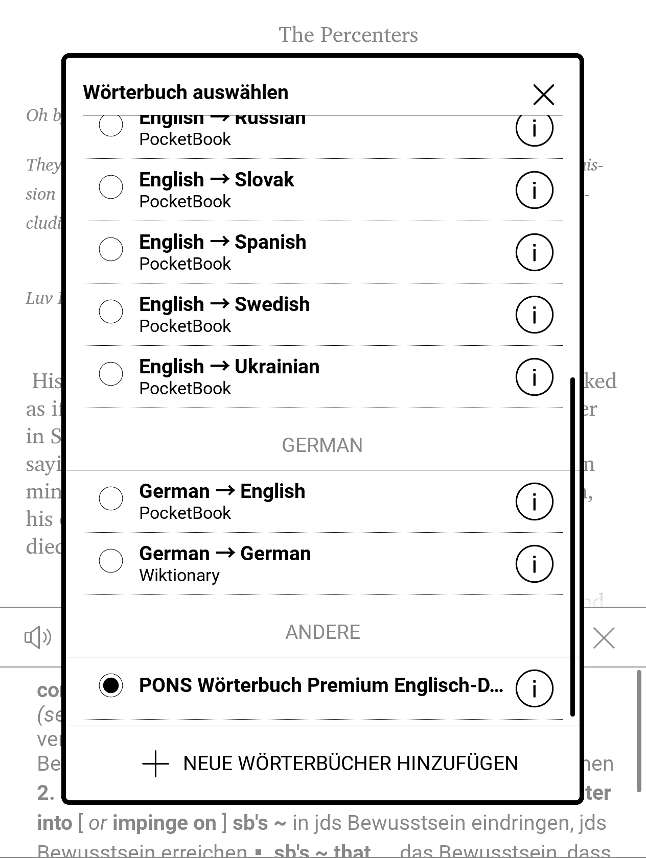

@Markismus:
Could only test one dic after another. If you copy all three to the device, they appear under one name only, and you don’t know which it has taken.
They also all appear under »Other« (»Andere« in German), instead of under »English → German«.
I had to compress all screenshots into one ZIP (upload limits here), and also include a screenshot from the original Pocketbook English → German dictionary.
On the Pocketbook, you have an app »Dictionary« as well as the (small) lookup area when reading a book. I enclose screenshots for both. For some reason, they all look alike.
PONS Premium EN-DE_reconstructed_replacingEndTagParagraphWithBreak .dic
Full: [ICODE]scr0022.bmp[/ICODE]Book: [ICODE]scr0023.bmp[/ICODE]
PONS Premium EN-DE_reconstructed_replacingEndTagSpanWithBreak.dic
Full: [ICODE]scr0024.bmp[/ICODE]Book: [ICODE]scr0025.bmp[/ICODE]
PONS Premium EN-DE_reconstructed_retainingspan.dic
Full: [ICODE]scr0026.bmp[/ICODE]Book: [ICODE]scr0027.bmp[/ICODE]
Full: [ICODE]scr0028.bmp[/ICODE]
Moonbase59 is offline   Reply With Quote

@Moonbase59 Well, at least we can now be certain the <br/> tag is stripped by convert.exe.
If you find other converted dictionaries in binary dic-format, that do show line breaks, could you sent a screenshot? Maybe we work back from that code to implement a linebreak that survives conversion.
It would be nice to create a tool to do the conversion ourselves. However, I have no idea how to reverse engineer a binary format.
